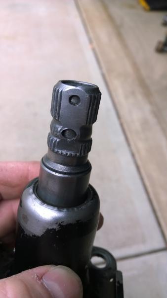

93 Krawler 07-22-2014 12:38 PM
2 Attachment(s)
I sheared the roll pin that keeps the sleeve from rotating on the shaft. The roll pin ran through the bottom hole. I would've thought the shaft would be splined, and not capped with splines. I welded it up, so I shouldn't have any more issues with it.
Attachment 7661
Attachment 7662
