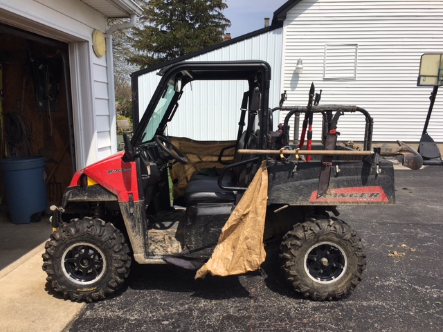

The stock wimpy 25" tires didn't last long running on the road. Recently upgraded to 27x9R12 and 27x11R12 Blackwater Evolution tires on factory RZR aluminum rims that were bought from Kevin.
Attachment 9469
Tires look really beefy compared to stock. Required a 1" wheel spacer on the front to clear the tierod but otherwise just fit.

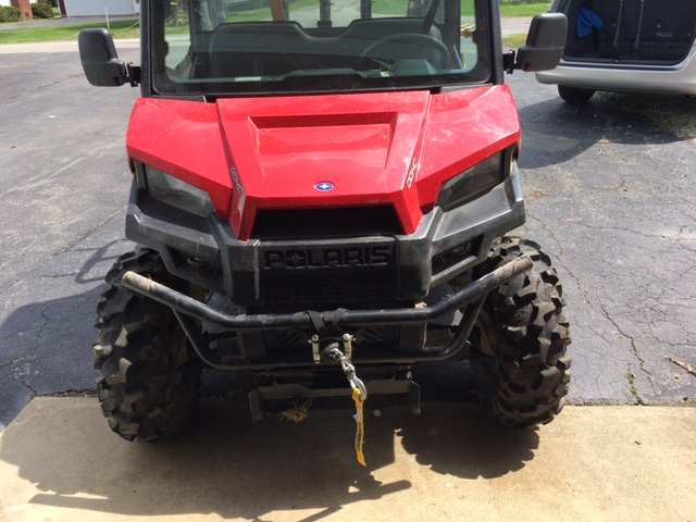

Picture of the front. You can see the winch and the quick mount for the plow. It takes about 1 minute to hook up the plow....you would want to take the mount off for any real trail riding.

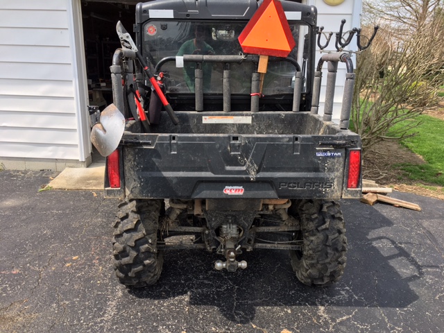

Pics from the rear.
