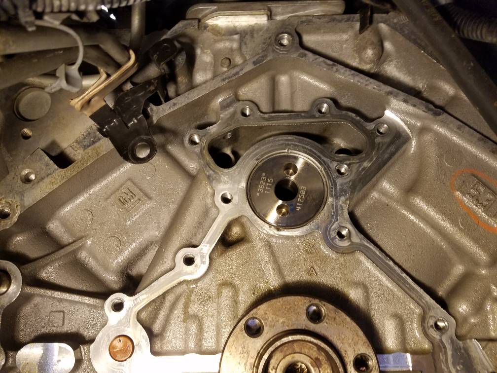

93 Krawler 09-23-2018 01:38 PM
1 Attachment(s)
Got the engine back after 6 weeks. Put it in and this is what happened. Still no oil pressure because its running out the bellhousing somewhere. I am beyond pissed. [emoji35]Attachment 10055Attachment 10056
93 Krawler 09-23-2018 10:43 PM
2 Attachment(s)
Pulled the trans out to see why it was leaking, and found the rear seal was damaged. I don't think the rear seal leaking would give me zero oil pressure. So now the question is, why is there pressure leaking in to the rear cover.
Attachment 10057Attachment 10058

93 Krawler 09-28-2018 10:14 PM
1 Attachment(s)
Got it all back together finally. Replaced the seal and no more leak. The oil pressure sending unit connector was loose, so that's why no oil pressure. All.good now.
So it is advised that no one uses Performance Engineering in Hamilton. First time took 2 months to get it rebuilt, only to walk 2 bearings 3000 miles later. Second time took 6 weeks to get back only to find a mangled rear main seal. This is why i do my own work.Attachment 10069
