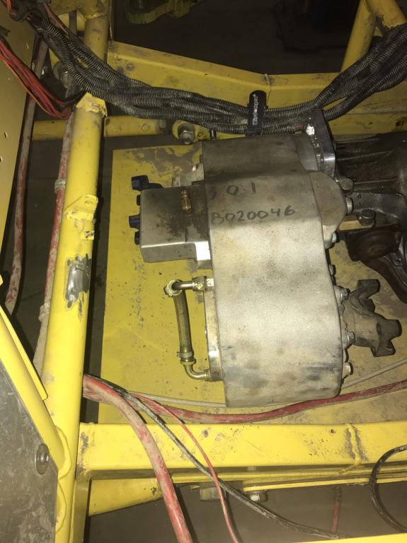

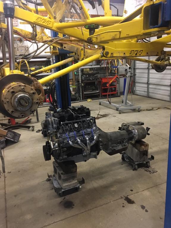

jeepmanjeff 11-18-2018 10:01 PM
1 Attachment(s)
Attachment 10141

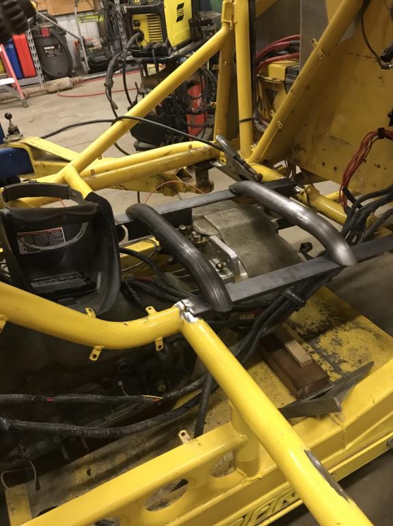

jeepmanjeff 11-18-2018 10:05 PM
6 Attachment(s)
Attachment 10142
Attachment 10143
Attachment 1
https://uploads.tapatalk-cdn.com/201...6eefbde241.jpg
Attachment 10144
https://uploads.tapatalk-cdn.com/201...459eb50681.jpg
Attachment 10145
Attachment 10146
https://uploads.tapatalk-cdn.com/201...c258822a80.jpg
Attachment 10147

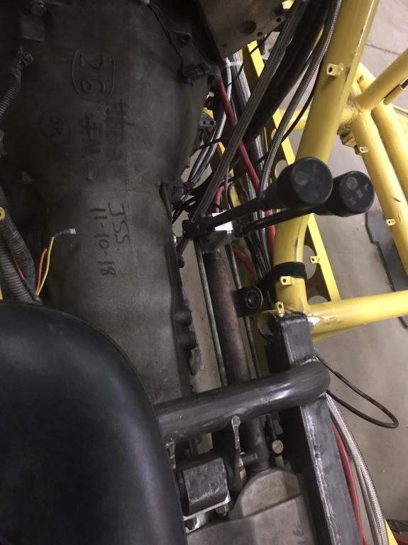

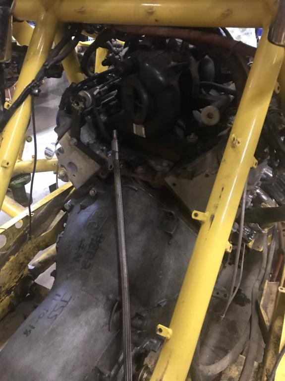

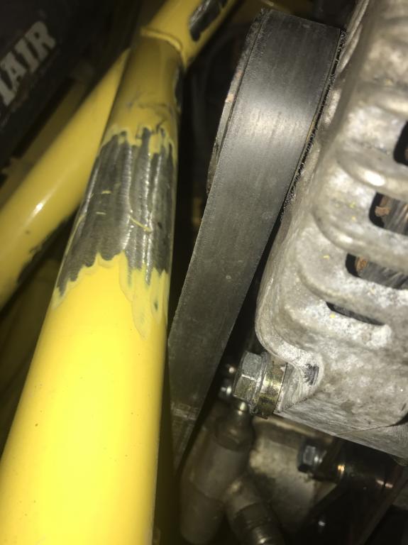

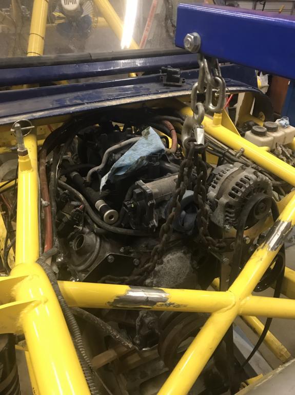

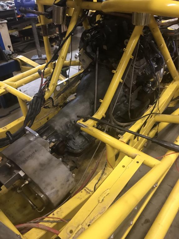

93 Krawler 11-19-2018 03:44 PM
Looks pretty snug. Any issues?
jeepmanjeff 11-19-2018 03:47 PM
Yep. Coil packs. Gonna look into it tomorrow
Try to maneuver it better. Zach won’t want hear this
93 Krawler 11-19-2018 08:47 PM
You can always relocate the packs and get longer plug wires. Are they all in the way or just a couple?
Smiddy24 11-20-2018 10:31 AM
I mentioned flipping the coils backwards (if that's possibly) and getting a longer set of wires. Lester also came up with a good idea on Facebook. I guess Jegs sells this rack where you can mount and hang them in any location you need.
https://www.jegs.com/i/UNKNOWN/335/5...MaAiUZEALw_wcB
jeepmanjeff 11-20-2018 11:01 AM
Just one. I am going to stand it up right and make little tabs for it.

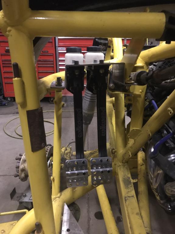

jeepmanjeff 11-25-2018 10:18 AM
13 Attachment(s)
Attachment 10157
Attachment 10158
Attachment 10159
Attachment 10160
Attachment 10161
Attachment 10162
Attachment 10163
Attachment 10164
Attachment 10165
Attachment 10166
Attachment 10167
Attachment 10168
Attachment 10169

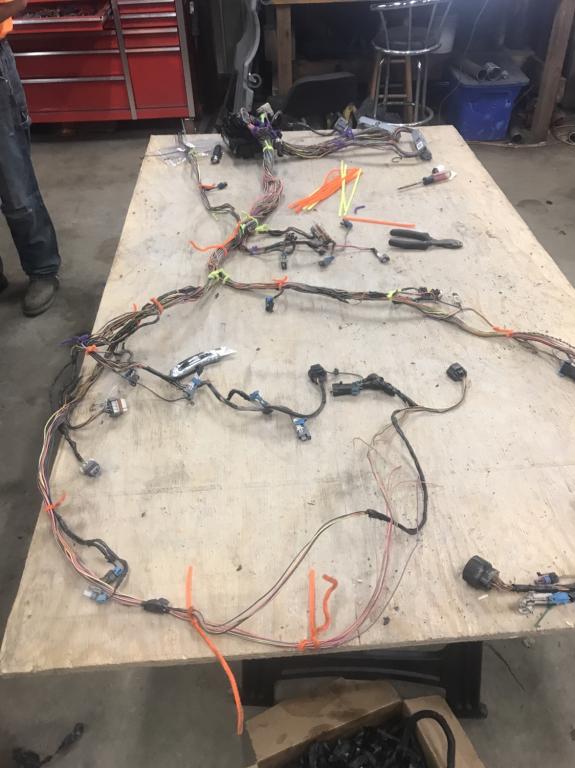

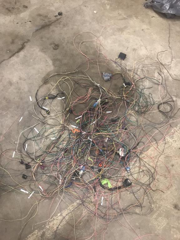

jeepmanjeff 11-26-2018 02:04 AM
4 Attachment(s)
Wiring done today
Attachment 10173
Attachment 10174
Attachment 10175
Attachment 10176

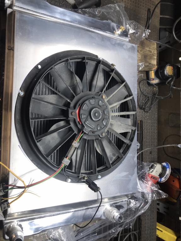

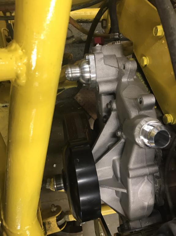

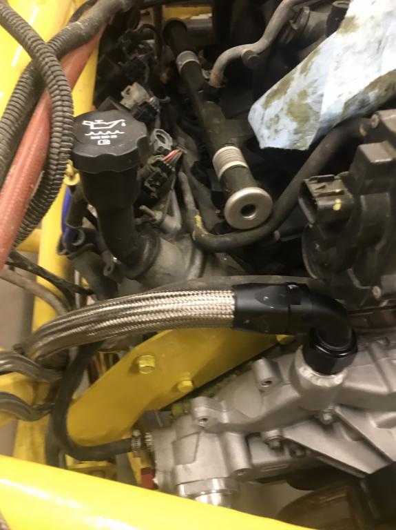

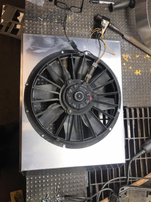

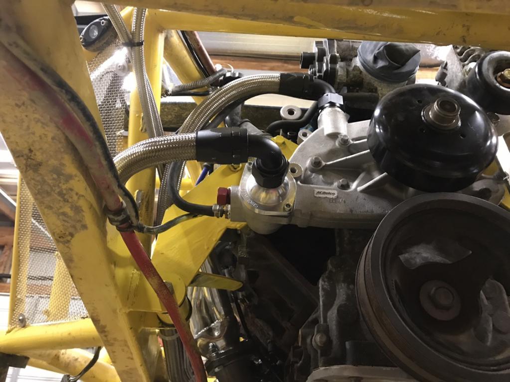

jeepmanjeff 11-28-2018 08:54 PM
3 Attachment(s)

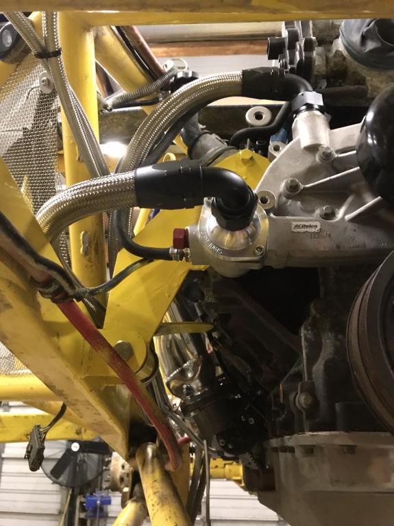

Got the water pump tapped for the thermostat and steam port done. Needed a 3/8 and 1/2 pipe die (harbor Freight $11.89)
Got the shroud cut out for the Volvo fan as well
Ken Garcia did the aluminum welding for me. Doing AN 16 fitting and stainless steel lines
Attachment 10186
Attachment 10187
Attachment 10188

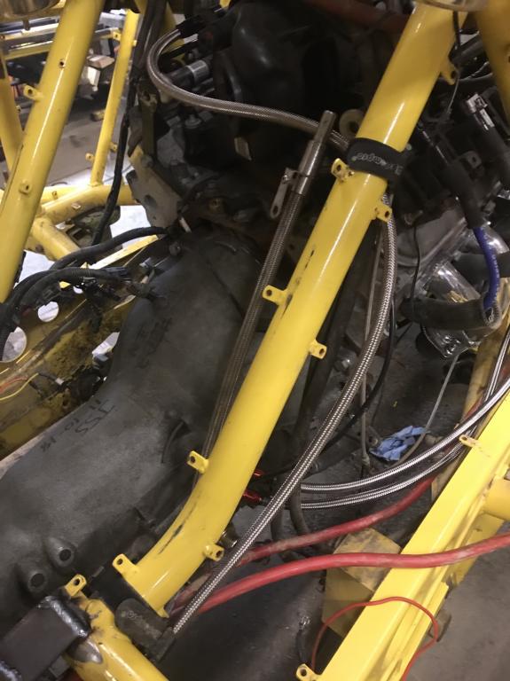

jeepmanjeff 11-29-2018 09:49 PM
7 Attachment(s)

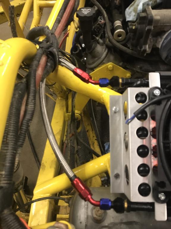

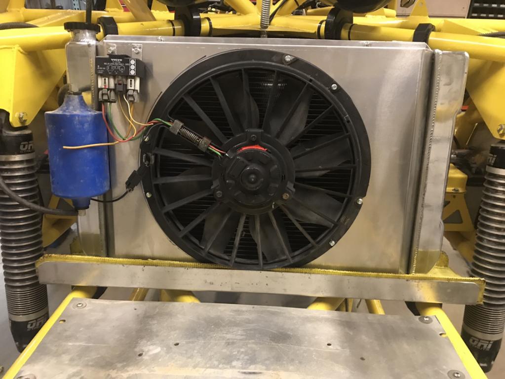

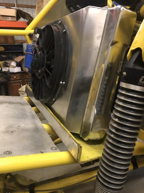

The radiator is installed and lines ran
I really like the AN16 lines. Well worth the money to do these. Really is not that expensive to do.
Attachment 10189
Attachment 10190
Attachment 10191
Attachment 10192
Attachment 10193
Attachment 10194
Attachment 10195
WrenchMonkey 11-30-2018 03:23 PM
Those are really really cool, but that's only like 7/8 ID, right? Is that going to be enough flow?
jeepmanjeff 11-30-2018 11:58 PM
1” is what I bought. Everyone has said yes it will
This is also what they run on the NASCAR cars

WrenchMonkey 12-01-2018 01:42 PM
Cool! Let me know, that could help with a packaging issue I'm having too.

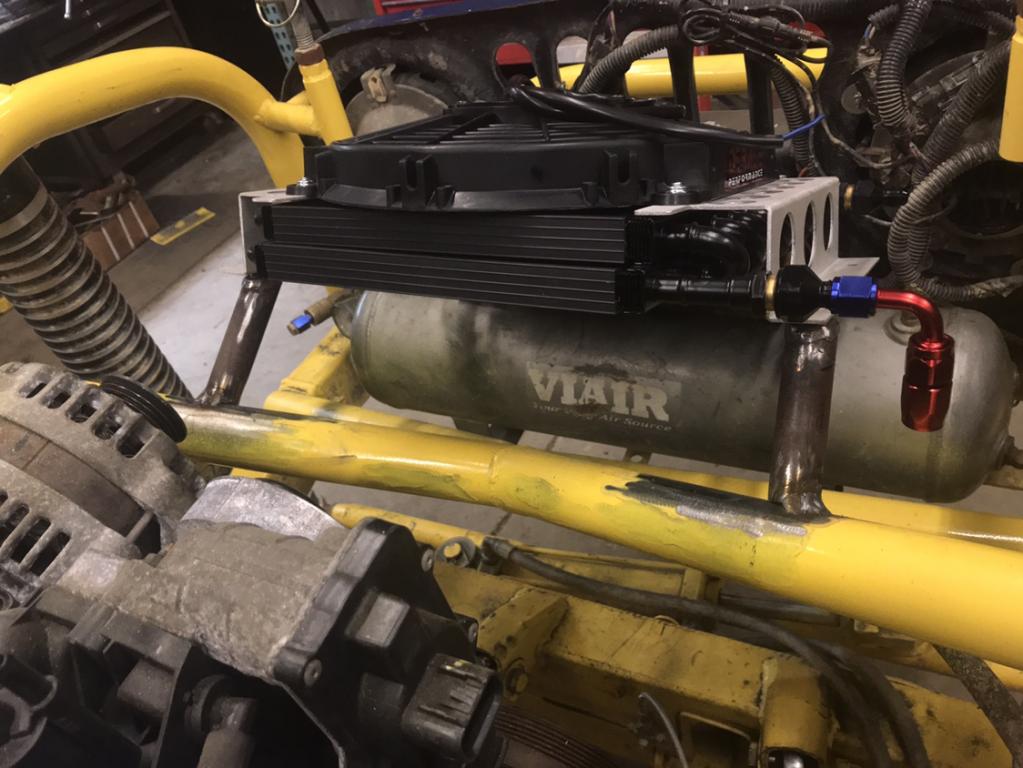

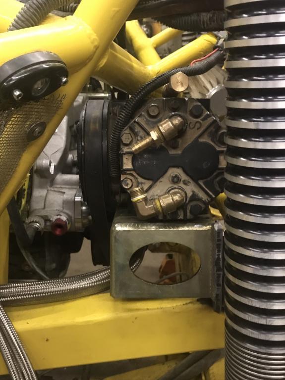

jeepmanjeff 12-03-2018 08:32 PM
4 Attachment(s)
Attachment 10203
Attachment 10204
Attachment 10205
Attachment 10206
WrenchMonkey 12-04-2018 12:38 AM
You managed to cram the york in? Nice!
If it's facing backward, does it spin the opposite direction? Does it mind?
jeepmanjeff 12-04-2018 09:24 AM
AES is sending one that is reverse rotation for me at no charge!. This company is fantastic!
