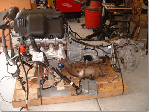

TomH 05-25-2010 05:02 PM
Originally Posted by Trigger (Post 38521)
TomH, what did the swap end up running you, if you don't mind me asking. I'm thinking $6-$7K?
You're about right on. I picked up an '06 Escalade (LQ9) including the 4L65e and all of the accessories, ECM, harness etc. for $4K to my doorstep. The motor/trans was pricey, but it was virtually new (500 mi).
http://www.hachiya.us/jeep/blog/wp-c...062_thumb1.jpg
Between the cam, Atlas-II with adapters, VSS kit, headers, etc. there is another $3K (Max).
