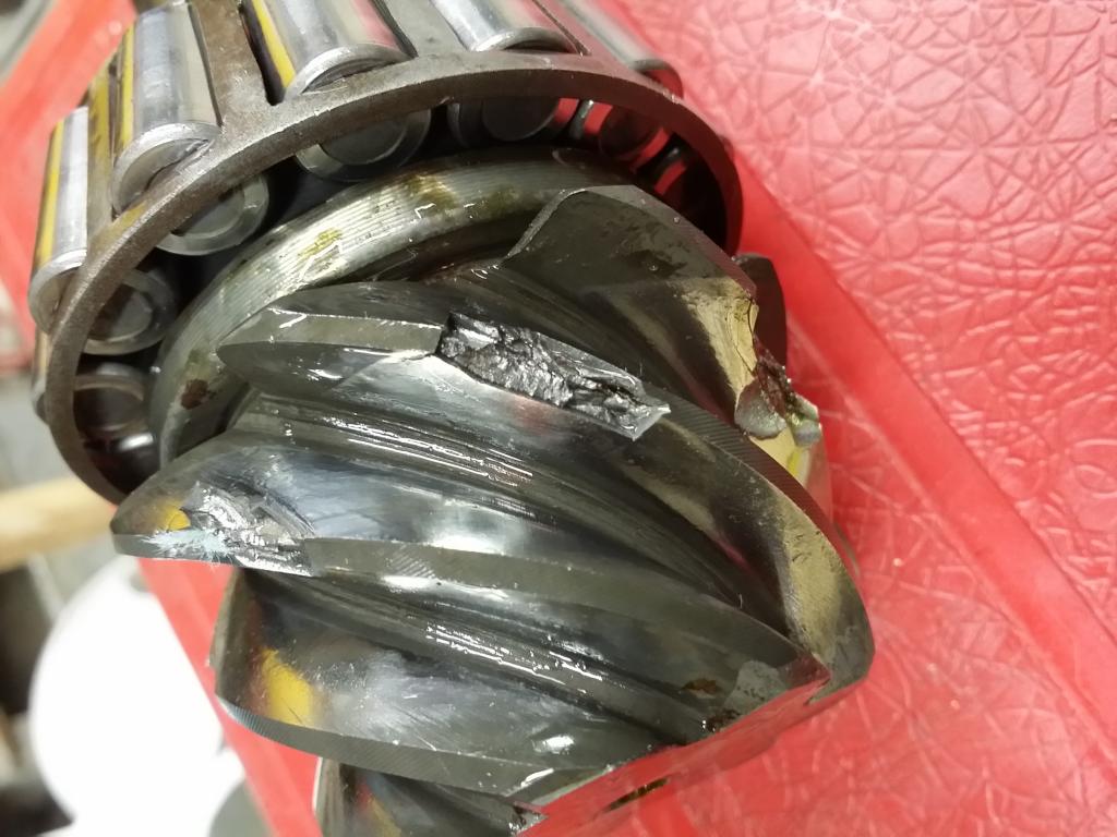

My bearing and race for my rear diff won't be in till at least next Monday for my rig, upon fixing broke stud in the rear housing I noticed metal on the drain plug. After inspecting 3rd member I noticed it didn't want to spin the way it should. Took it apart and discovered top pinion bearing race cracked in 2 places. Will try my best to get this thing together, would be nice if I had a day off somewhere between now and Rush.

Since I've never set up a ring and pinion nor have I ever used the instruments needed to properly set and adjust backlash, I'd be more than happy to learn how using your diff.
Will let ya know when I'm ready, I will be showing my boy and his buddy in the process, I quit using dual indicators years ago and only break it out when I'm setting up a diff that will be run on the street. For Hardcore offroad use you have to setup with the least amount of backlash possible without binding Ring and pinion. This helps keep em from breaking under shock load conditions.
Mine are always to spec, and have never failed. You sure yours aren't getting too hot?

No chance of getting hot..ha ha ha!!! This is my last pinion after 10 years of wheeling, 5 of those years were on 39.5..with the style wheeling that we do our gears never spin fast enough for long enough to generate enough heat to expand to cause any damage. This a significant increase in strength in any differential if setup tighter than factory. If I set em to factory specs it will not last long and will break sooner. Changing your diff grease at least 1 time a year and inspecting backlash and metal on plug keeps you aware of what's going on in there.

I have a better picture somewhere of my pinion where it shows all of the stress cracks where all of the teeth are ready to break off, the less contact the gears have "less backlash " the lest contact point the ring and pinion have...but you have to be careful not to cross the line and go too deep and cause binding.

That's the first time I've heard somebody say to set the gears up tighter than spec for off-road use. Not saying it's wrong or right and understand the theory about the shock loading, but also concerned it could cause other issues. I've always set mine up to factory specs but have also always kept it street legal and therefore need to be able to run down the road at reasonable speed (majority of trails I have ran over the years required some street driving to, or between, trails).....my road speed is only limited by the unbalanced and trail scarred 40" TSL's.

I second the "set them up tight" mantra. Drag racers also set them up tight for the same reasons. I ran the gears on my built stock axles set up slightly tighter than spec, setup by a professional who drag raced. They are still around about 7 years (on and off-road use) after initial setup on someone elses rig. And you guys know that I beat the hell out of that set of axles.
