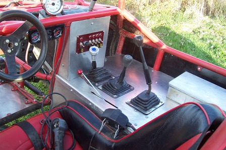

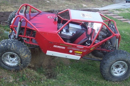

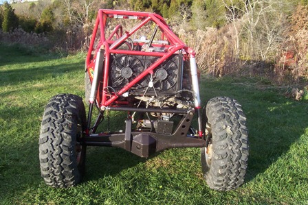

finnally finished this thing! if it took any longer id have to change my name to carwash jr.!!!! jk, cw. heres some pics.

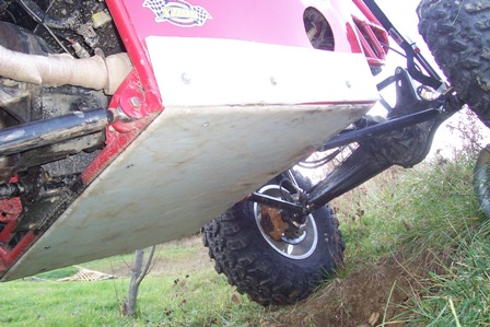

computer designed chassis. 106 wb, 36's on walker evans b locks. could def go bigger. uhmw flat belly/skid. 22re, made my own fuel injection harness. w 56, doubler with 5.0 in back case. everything you can possibly throw at a toy axle. lexan skins painted from backside. ect, ect, blah blah blah..... came out pretty nice though.

Thanks for the props. Your rig is definitly a masterpiece. After seeing it in action I was very impressed with how it handles at speed, and also how stable it is. It has an incredibly low center of gravity that make lines that would be impossible for some rigs doable in this one. You better sell it quick cause with a little more seat time and a little tweaking, I think you won't want to sell it anymore.

love the plastic skidplate, though.
