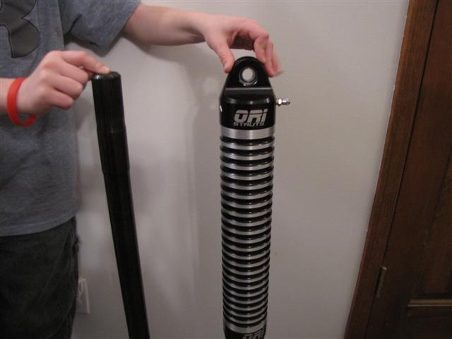

My junk!
How's this for bling..... a long side RCV Dana 60 axle made of cryo'd 300M with a 16" ORI strut thrown in for good measure!

Old 03-24-2010, 09:05 PM   #10
you take the worst bling pics ever... show us the fun part of that RCV... let's see that red bell!!!

Old 03-24-2010, 09:17 PM   #12
Here's the other stuff..300M croy'd bell , cromo stub and the bad-ass() toilet plunger thingy.
