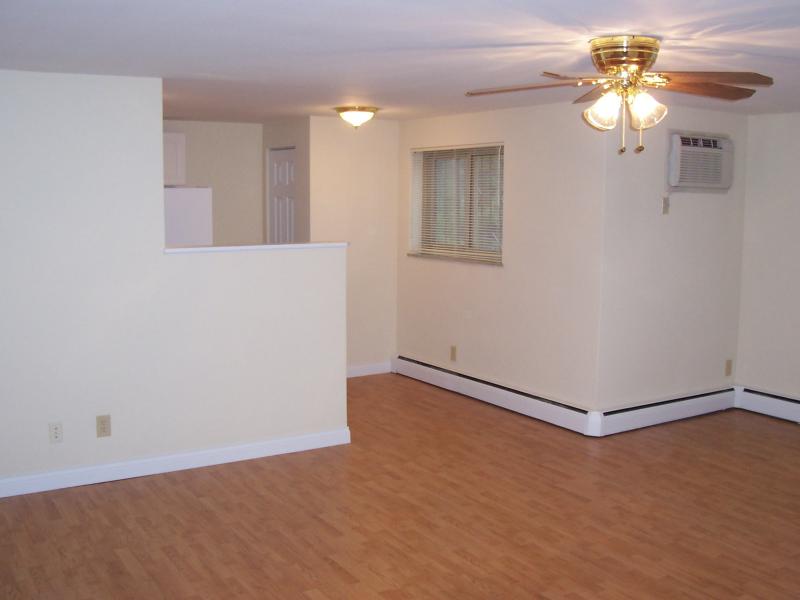

I had to put about 700 sq ft of this stuff down in a 2 bedroom apt in the basement. Had some long runs down the hallway that sucked real bad.
