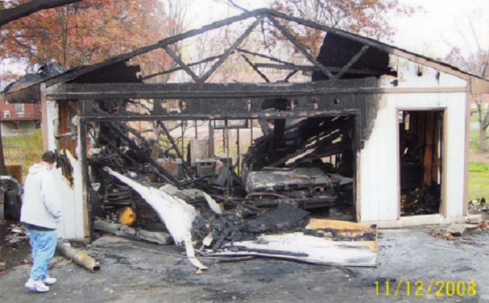

I know the fire cheif told me that they always expect the worse...
my garage burnt down in Nov last year and i had all of the bad stuff, laquer thinner, paint scraps, old oil, gas cans, torches, etc... i was lucky, i think the only things that i thnk exploded was the gas cans and laquer thinner.... the fire stayed high in the building with 8 tires in the rafters...
it was a 3 alarm....
lost a lot but it all worked out in the end...:)

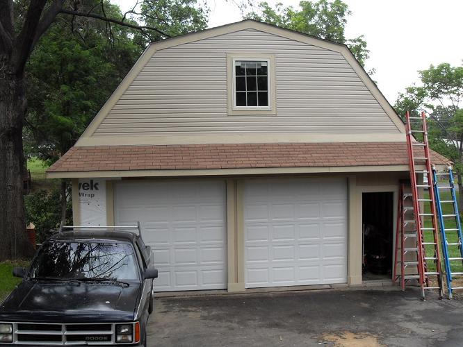

Yea carwsh that was pretty much my first reaction... I wasn't home when it happened...
From the pics of your shop i have seen on here you have a much bigger place than i do and i lost 25k in tools plus the building...
The insurance company treated me good...
I built the new barn this spring..
