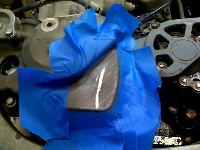

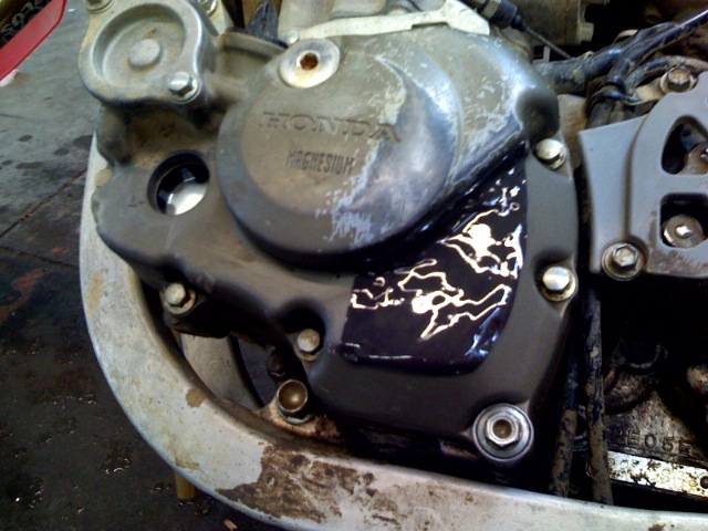

There was a thread... "Best JB Weld fixes" or something like that...did we lose it?
ugh... anyway, here's my most recent...
Cracked the left side case on my crf450. Laid it down in a creek and an unlucky rock pushed the shifter into the thin magnesium case and cracked it in a couple places... so i JB'd it! Did it all fancy, taped off the area and everything... Reason: New sidecase is almost $400!!
So, lets see your fixes!

I could have tig welded it for ya. Does look pretty damn impressive though!
I had a chain ram into the rear of my 400EX's case and split it and had success with the same method. No pics though. ;)
Old 09-28-2009, 01:32 PM   #3
I could have welded it myself, but would have had to pull it off... i would never trust it welded, just as i wont trust it jbwelded. this was just to get the bike back on the trail til i locate a used case half.
thanks tho!
