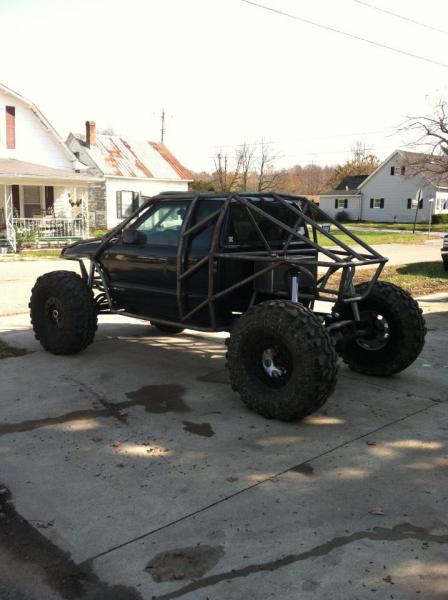

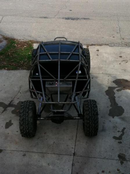

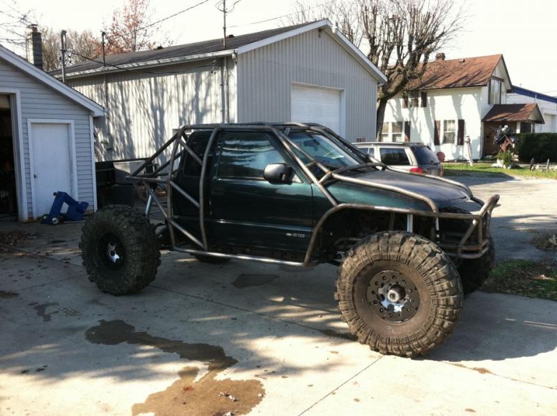

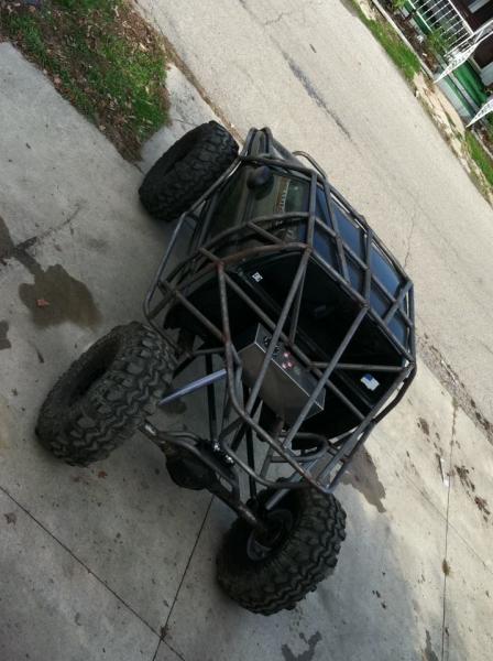

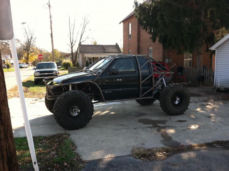

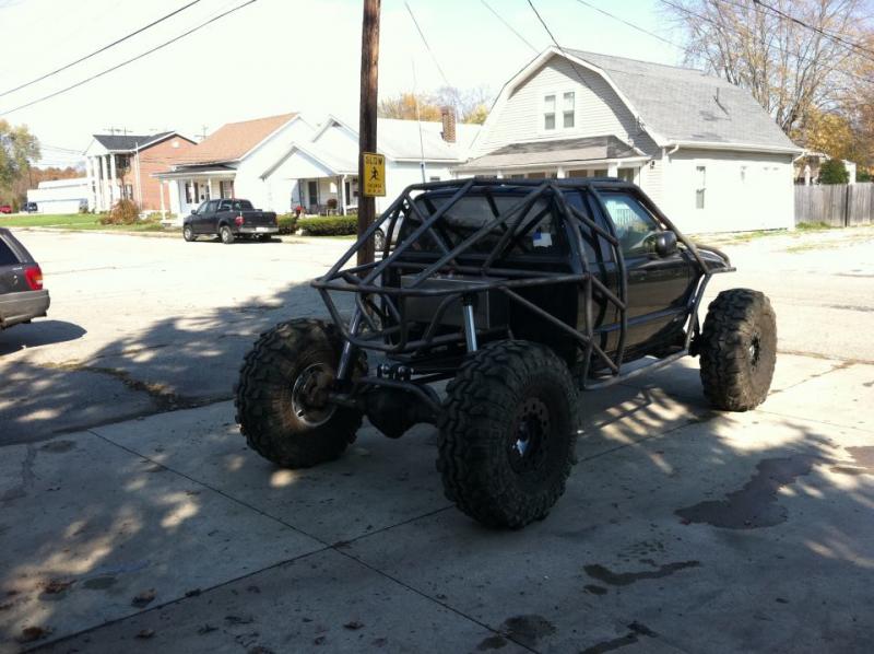

a few pics of an s10 i am wrapping up for a friend..
2000 cab
tbi 350
th400/205 clocked up with trail tech fab clocking ring
tons
43 sx's
1 1/4 heims
2' x .25 wall links
2.5 fox airs
hummer locks.
1 3/4x .120 cage
few other goodies...
final number are 26" belly 129" WB
