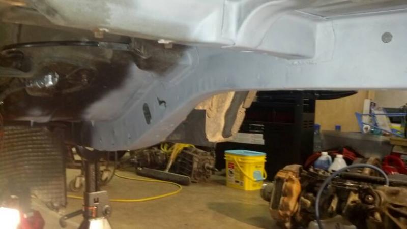

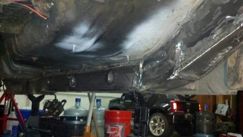

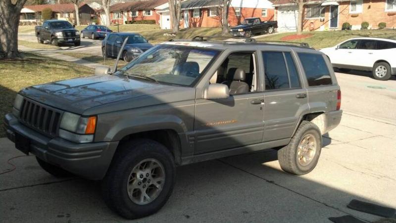

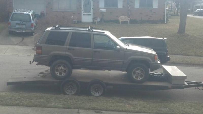

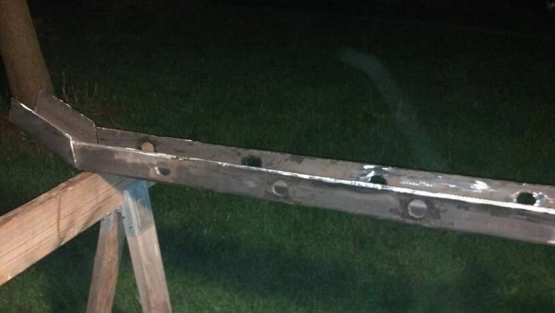

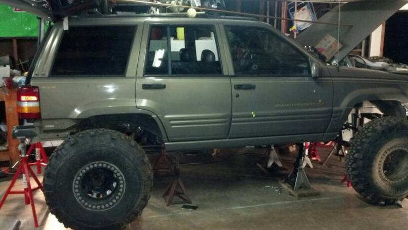

Grand Cherokee 1 ton build
This is my new wheeler. 97 grand Cherokee limited 5.2
Plans
Ford king pin 60 5.38 gears welded
14 bolt 5.38 gears welded
Full frame reinforcement
Exo-cage
At least 38s on bead locks
231 with sye
4 link rear on coils
3 link front on coils
Tons of little stuff
Progress up to this point has been all the metal work looks like I haven't done much but cleaning the frame of all the stock brackets took forever but I think it was worth it in the end. Rear passenger side welded in all the rest of the pieces are cut out and ready to weld in. I did really like the templates. I have been watching to much extreme 4x4 hahaha

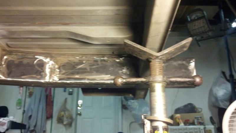

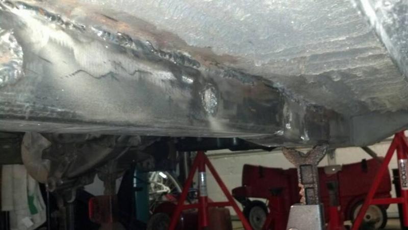

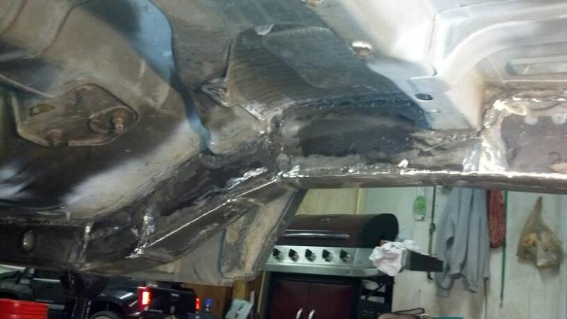

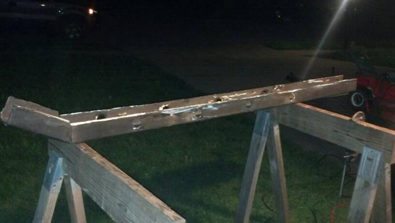

The passenger side frame rail almost done. Just need to bend the front up at the fender well. All goes as plan and that will be all one piece. Driver side should go faster.

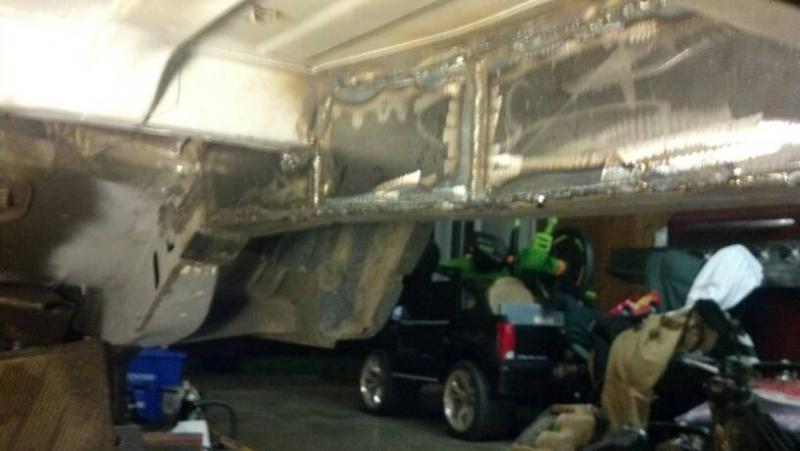

Got all the frame cleaned and ready to weld for the long section under the passenger compartment today and test fit a little. Start on call tomorrow so if I can get that fully welded in and started on the other side within a few days that would be great

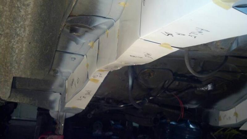

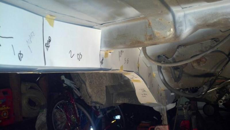

Pics of my templates they really have made life a lot easier and cut down on so much test fitting.

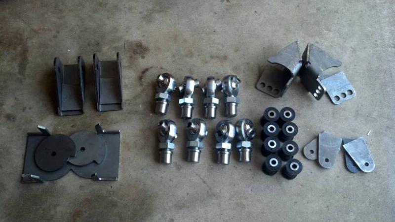

New bling for the grand
And only 3 more plates to weld in and the driver side rear is done. Ready start working on the links and put these brackets in

Got the grand up to ride height (we think hahaha) tonight. Axles are under and centered for link measurements. Looks like 116½ wb A couple of pics with tires sitting up against axles. Gonna cut the body for clearance and get some links in the rear next. Thanks huntingmatt418 for all the help tonight
