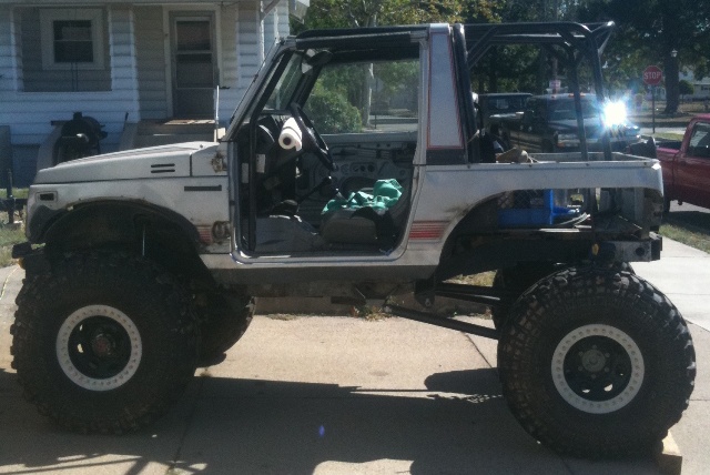

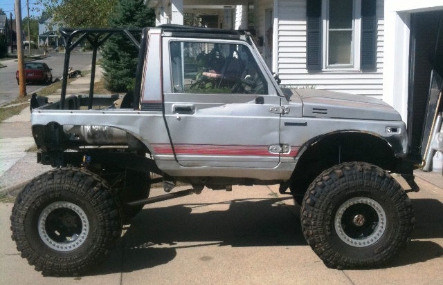

Old 09-27-2010, 09:10 AM   #33
9/26 - Update
Rear suspension substantially finished. I stuck stock tj coils in to move it. The spring rate is great however, the coils are about 4-5" too tall.
Once I cleaned up in the garage some, I put the squirrel back inside and it promptly thanked me by puking more gear oil on the floor.
Since I got so much done, I must be ready to leave for work again.

Old 09-27-2010, 09:30 AM   #34
nice progress. now you and george can race to see who gets on the trail first
Old 09-27-2010, 11:11 AM   #35
krawlin85toy
krawlin85toy's Avatar
Location: Hamilton
Posts: 265
Images: 76
still have a rig on trails... so I win lol:)
Old 09-27-2010, 12:34 PM   #36
lookin good! when will be the maiden voyage?
Old 09-27-2010, 01:11 PM   #37
Does the Jeep count? My doors open all the way. :p
Leaving town pretty soon so I'm gonna guess New years:confused: Just when wrenching weather gets great, I go work......go figure.:(
