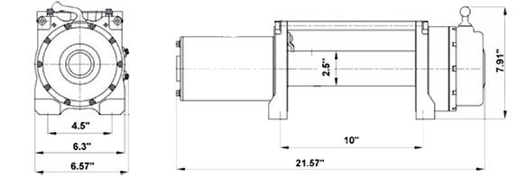

I plan on making my own winch mounting plate for my MileMarker se9500c. Could anyone get me some measurements from their's so I have somewhere to start? Thanks. I know the bolt pattern but am interested in overall height, width, etc...

Check on ebay for some measurements. I have found measurements there before. The 9500 warn is 4.5'' by 10'' bolt pattern.

SE9500C (76-50246) Technical Dimensions
