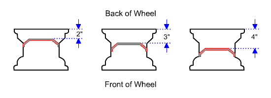

Backspacing is the measurement from the inside of the rim to the interior WMS.
You are asking about the measurement from WMS to the outer part of the rim.
So, take the wheel width and subtract the backspace and that should give you the measurement that you are looking for.
If we work this backward, an 8 inch wheel width - 5.25 inch desired outer measurement yields 2.75-inch backspace. You could probably get by with a fuzz more backspacing since you are welding on a beadlock kit.

Add 1" to the rim width for the weld on beadlock. This is what I have gotten with both TSL "SX" and IROKs on weldon's. So an 8" rim becomes 9", a 9" becomes a 10" well you get the picture.
So just subtract the amount of space you need on the front side (the hub length) in your case 5.25 inches. So 8" rim + 1" for weld on beadlock - 5.25 font space required = 3.75" BS
If you start with a 9" rim you can do 4.75" BS
I would take off an extra 1/4" so the hub is inside and protected from rocks, so 3.5"BS for an 8" rim.
I have 8" eaton steelies with 3.25" BS that I did weld on beadlocks and the hubs are nice and protected.

The above information is correct. Subtract the BS from the total wheel width and that gives you the measurement from the WMS (where the lugs are) to the other lip of the rim.
However, unless you buy custom wheels at a premium price you don't have much of a choice when it comes to off the shelf wheels. I went through this a couple of years ago when thinking about going to 17" wheels but there was only one BS available that I could find on 17x8 wheels and that was 4.5" which would definitely make a locking hub or flange on a D60 stick out. I could special order a set of wheels from Summit that only had 3.5" BS but it almost doubled the price, and other than that it was going with some other company for even more money. Just couldn't bring myself to pay the extra money.
