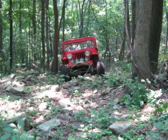

In the one picture, you do indeed see a winch cable attached to my front bumper. I just couldn't make the climb, but I was only one of three that tried the hill. This is the last portion of a stair stepped climb. I was thrilled to have made it up the first two sections of the climb.

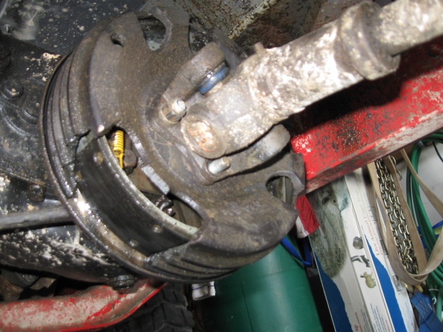

Late Saturday, we headed back to camp after a day of wheeling. All seemed to be going well. Then when I shifted into 2nd the 3A started vibrating and making a bunch of noise. Couldn't figure out why after looking underneath. The driveshaft was tight and appeared to be straight. So, I drove the 5 miles or so back to camp in 1st gear. Since the wheeling was done for the weekend, upon reaching camp, I loaded it on the trailer in time for supper. Supper was a shrimp boil. Shrimp, crawfish, two types of sausage, potatoes, corn on the cob, and chicken all cooked together in one large pot.
So, the big picture is my carnage and what I am hopefull is the extent of the problem with my vibration. This is the parking brake coming out of the transfer case. In addition to the missing piece, the drum is fractured nearly 1/2 way around. I think I broke it in the rock garden. I made it up the garden on Friday with some assistance from a spotter. I then went down the garden and back up it again Saturday. Obviously, Saturday's climb was the damaging one.
