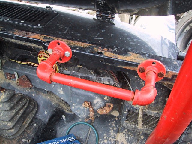

Would it have come with the sweet ass plumbing pipe grab handle? No deal if not...
It is very custom. I can make you one if you want.
