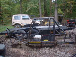

What is this cage worth? I am thinking of buying it to use on my Sammy. It is 1 1/2" .120" DOM Tubing. Does it look safe? I was hoping someone could tell me as I am going to look at it tomorrow. Thanks Guys!

any side shots?
Old 11-27-2009, 04:31 PM   #3
Here is one...
Old 11-27-2009, 09:20 PM   #4
Make sure all of the welds are good, there are NO dents in the tubing and the over all structure has not been tweaked.

bends are sharp. not the best but are you entering the pro circuit with it? what type of tubing used? and wall thickness? I made my 1st truggy and brought it to haspin and ghost rolled it down a hill for a test before I ran it.

I beleive this cage has a alot of potential,but inorder to be safe and strong,I would move and add some tubes that are more functional.REMEMBER,SAFETY FIRST.Good luck and have fun with your build.Also,sounds like the guys over on PIRATE4X4 are giving you some good advise also.

Sorry, don't do paint,but the tubes I was refering to is the main hoop which is directly behind your seats should have a X design for strength in the event of a rollover.Sometimes flops are very violent,also the long tubes running from the main hoop down to your rear shock mounting area could be moved out to the 90 degree bend of the main hoop for additional strength.No one likes to rollover,but if you do,you need all the protection you can get.
