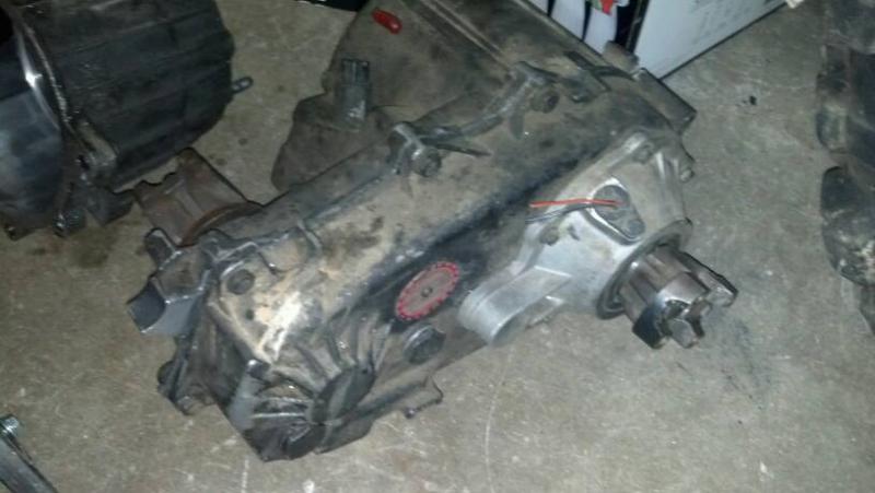

After some prying and pulling was able to split the 249 and get out the input and planetary. The 231 was a lot easier to split. It already had a 6 gear planetary that I could use with my input shaft. Cleaned it up and put it back together. Hope to put it up in the jeep in the next few days

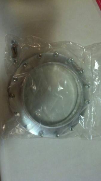

Ordered a custom fuel cell from RCI. It is the 30*12*9 but I had them not put in the sending unit or pick up lines on it. I bought a fuel cell adapter ring from genright that uses the stock jeep sender with the In tank pump and regulator.

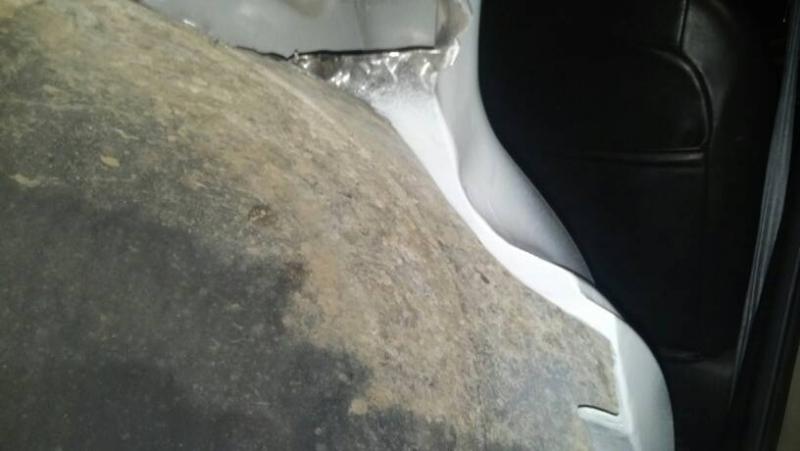

A few pics of the fender and door on the passenger side after the cut. I started the fill in process. After a lot of trimming and fitting I got the fill in piece to fit and filled. Not to bad since I hadn't ever worked sheet metal before.

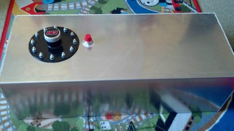

Also got my fuel cell I ordered from RCI. Looks good. Plenty of room for the genright adapter
