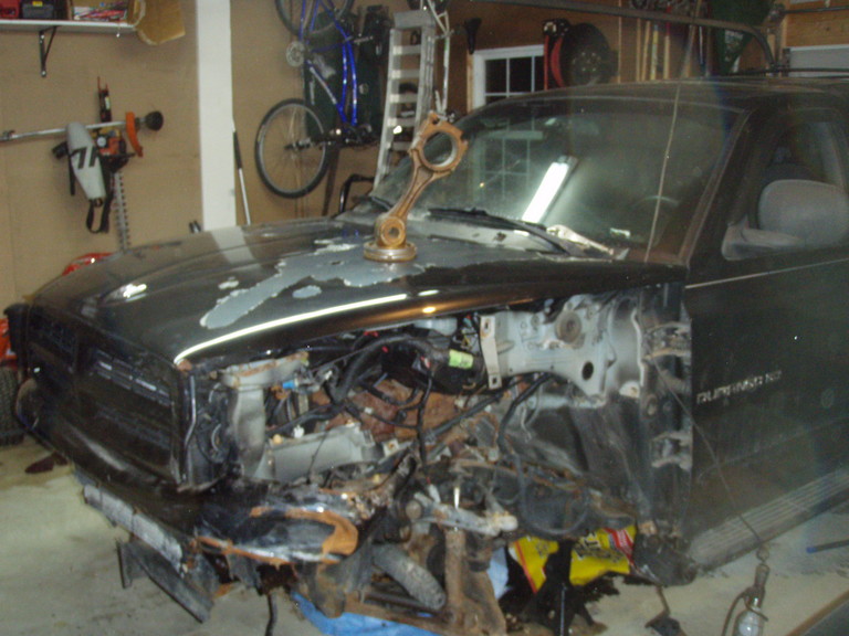

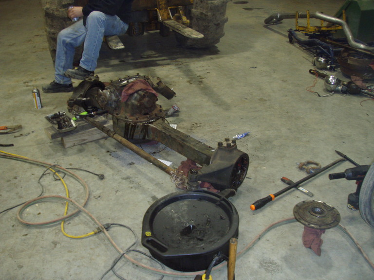

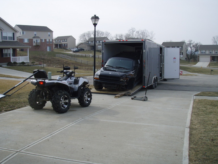

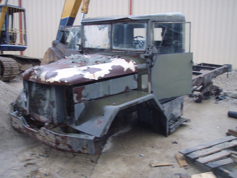

some random pics.

Old 02-12-2008, 10:04 PM   #48
another
