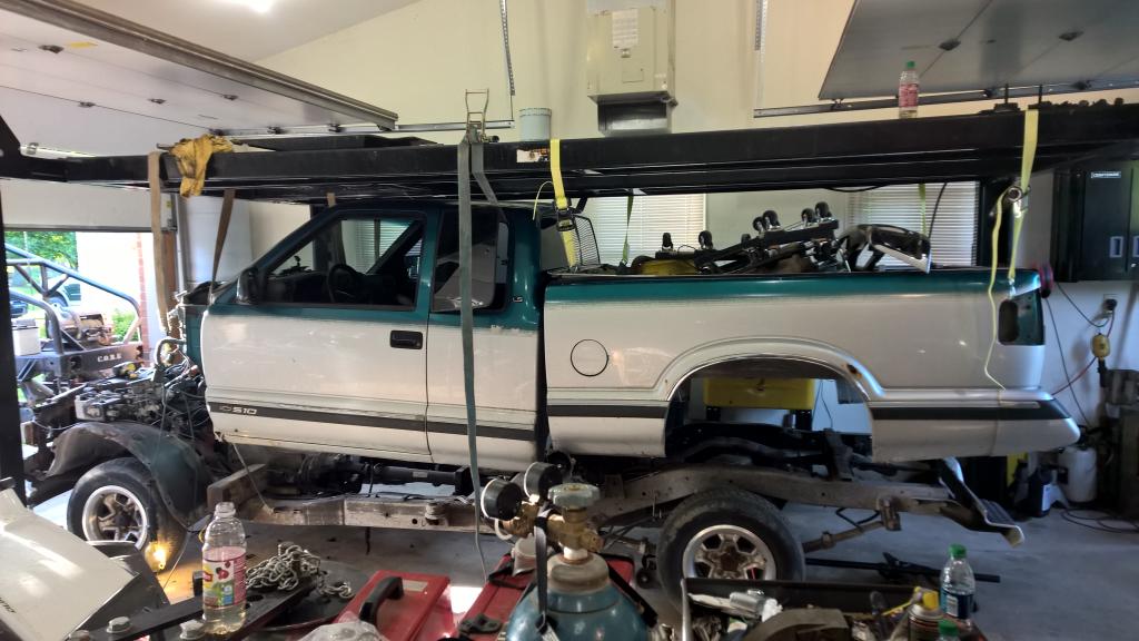

The cab comes off tonight. I will work on wiring and other interior stuff until its time to chop up the rig.
