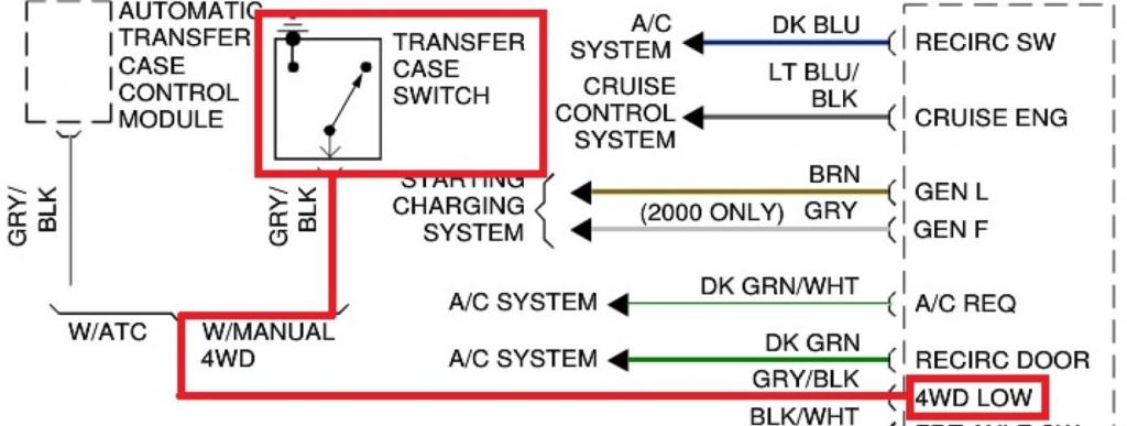

I pulled the harness mostly back out so I could run the 4 lo wire and see what the deal was with the MAF sensor. I was thinking that I attached one to many black/white ground wires together. GM uses black and black/white wires for sensor wires too, not just grounds. Well, that wasn't the problem, they were all good. When I shortened the harness, I staggered the solder connections so there wasn't any next to each other and used shrink tube. For whatever reason, I didn't stagger the MAF wires. Well the shrink tube shrank too far, and a few pointy soldered wires were sticking out and touching the other wire. I fixed those and now the IAT reads within 2 degrees of the coolant temp, or room temp... I'll know tomorrow how the 4 lo wire works out.

I took it for a spin today, and it runs great now. IAT temps are right where they should be. The speed is now correct in 4 lo too. Looks like I'm good to go. Windrock here I come.

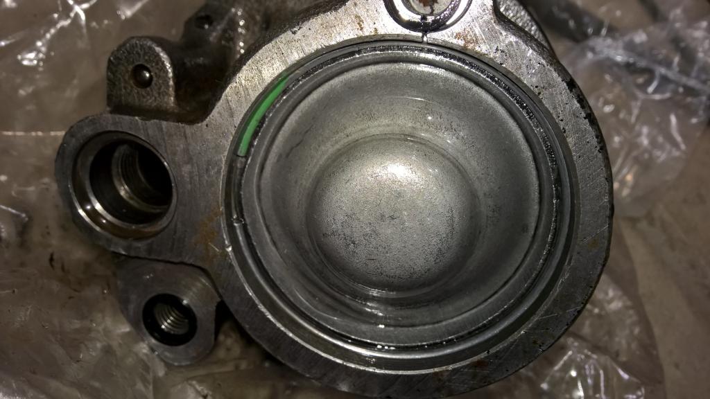

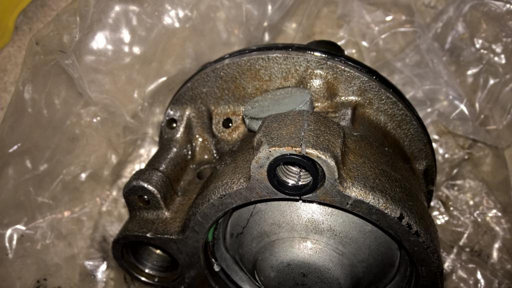

Started having steering issues in Harlan last month. The power steering pump shaft broke. Had a spare, but it didn't work very long, so I figured it was a bad rebuild. Decided to do the west Texas mod to the flow control valve to increase bypass pressure. I also drilled out the pressure fitting from 5/32 to 11/64. 1/64 bigger... They say not to drill it bigger than 5/32, but did it anyway. Got it all back together, bled, and fired it up. Went lock to the driver side, smooth easy turn, went lock passenger and it made a noise and the steering got hard. I could rev it up and it would get easier, much like the spare pump I put on in Harlan. I figured that mod did it in, so I put another pump on it and removed the modded valve and tried it again. Lock driver was good, lock passenger made the pump die, bad, started pouring fluid out the can seal. It cracked the housing and blew out the cap on the back. I have a hard time believing that 1/64 bigger hole leaving the pump would do this. May be wrong, dunno. I'm leaning on the orbital being messed up. So I got another orbital, and new 5/32 pressure fitting, and I'm trying it again tonight. Anyone had this issue before? Anyone know of a place that would be able to check the orbital out?

The large hole in the output fitting should not cause any excessive pressure. If it is too big it will allow too much flow with not enough restriction (therefore no pressure) at low rpm. I know that one from personal experience .
I have blown the cap out of the back before also but never cracked the housing. How far did you go with the West Texas mod? I recommend only removing the factory shims and tightening the nut all of the way down. You can easily cause too much pressure if you start adding shims under the spring. That is how I blew the cap out on mine. If you want to mess around with the pressure I highly recommend putting a liquid filled gauge in the pressure line so you can see where you actually are at max pressure. I usually don't go over 2500 psi when you are at full lock.
I stretched out the spring to 2". I removed all the shims. I did the 1/16 shim and ground down the pin. I thought the same thing with the pressure fitting being too big. The shim mod was removed before the last pump imploded. So, I dunno.

Have you pulled the cap off the back of the cracked pump to look inside? I am thinking one of the vanes may have broke and gotten wedged inbetween the cam and rotor maybe???
Was that a rebuilt pump? I have seen a lot of bad pumps coming from the rebuilders lately for some reason.

Have you pulled the cap off the back of the cracked pump to look inside? I am thinking one of the vanes may have broke and gotten wedged in between the cam and rotor maybe???
I haven't pulled the cap off yet. I would imagine the internals are a mess. There is about 1/2" of play in the pump shaft now.
Yes, was rebuilt.
