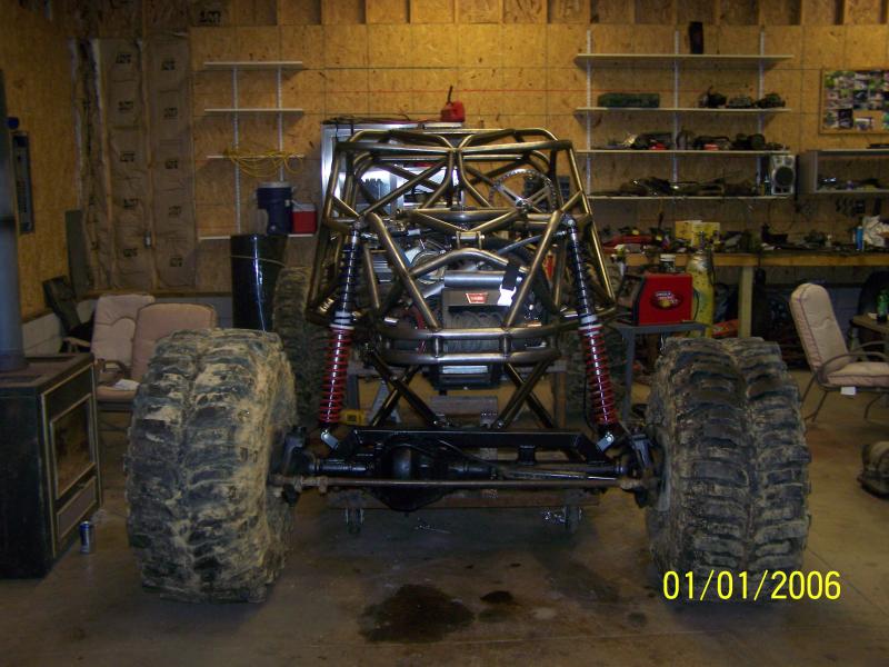

                          i run 1.25 all way around got my arms the other day so 1.25s on steering to shortly
