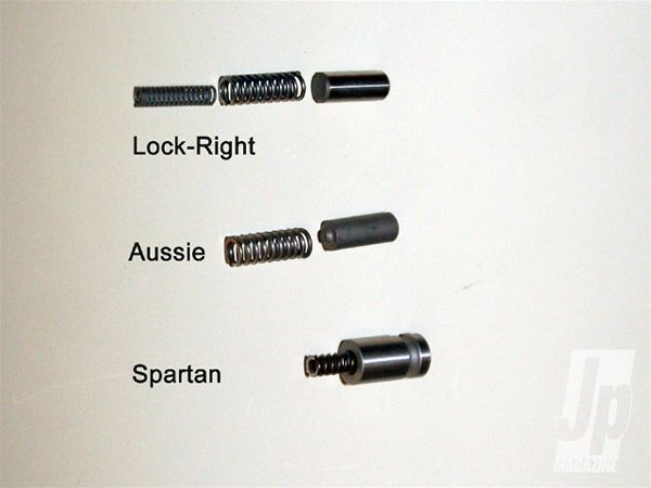

                        • #13
                          Mine is the older version (12 years old) and cracked where the pins are. The holes are also very oval shaped where the pins go also. That is why I tried the parts from my friend's old one (of the same design).
                          So no one has used the Spartan?
                          Comment
                          • #14
                            The new lockrite didn't look thicker where the pin sits in ? 2 holes on each part should be oval, did your new 1 come with dual springs and carrier pin ? I have setup 2 Spartans for a guy last year and I don't remember it coming with new heavy duty carrier pins. The 4 little pins are just a little bigger is all on a spartan...... so does your locker stay engaged or won't engage?

                            • #15
                              Here is some info I found
