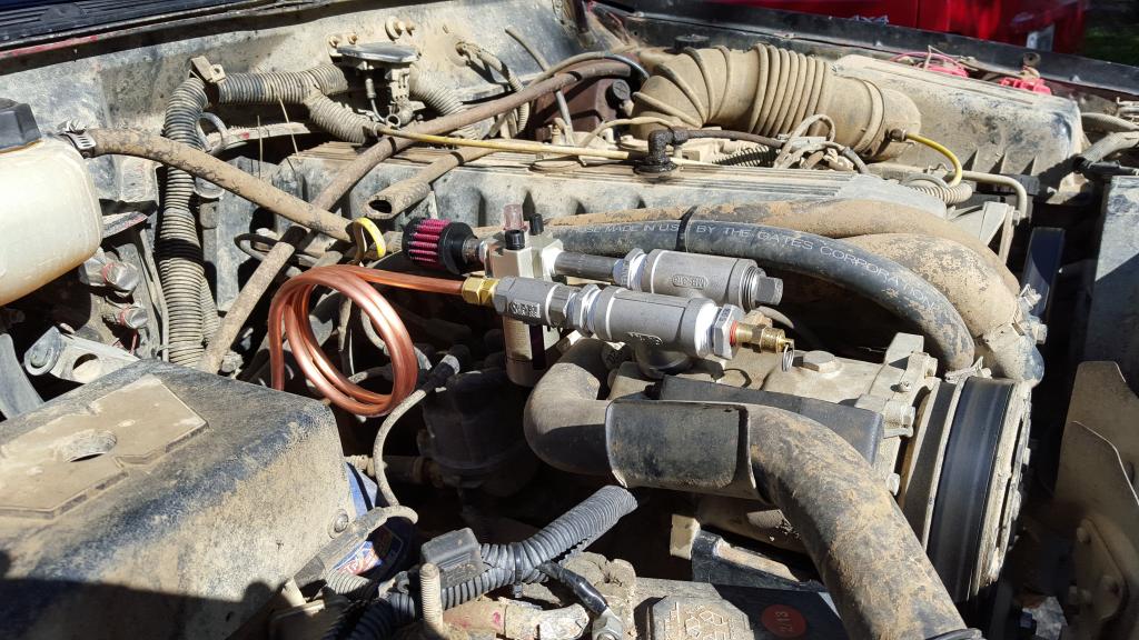

    Years ago, I capped the compressor fittings with 3/4" NPT caps. I seem to remember having to make them fit, but they eventually did. I replaced those with tees (with a ton of teflon tape for insurance) then reduced each leg to 3/8". I considered 1/2", but it really seemed bulky, and 3/8 should still flow triple what my old 1/4 would. (I saw it on the innerweb. Has to be true.)
    For the intake side, I got a filter from amazon (p/n UP-104, $12) and an oiler from Harbor Freight (#68233, $11.) The front of the intake tee is just plugged, for an easy access point if I ever have to oil it manually.
    On the discharge, I got a 175psi safety blowoff (Viair 92175, $9), and a check valve good for 200psi at 200*. From there, I ran 3/8" copper tube down the firewall. I added a coil (wrapped twice around a coffee can) to hopefully absorb some of the movement of the engine relative to the body. (This is also a decent way to dissipate heat before running rubber hoses, but mine is all metal lines.)

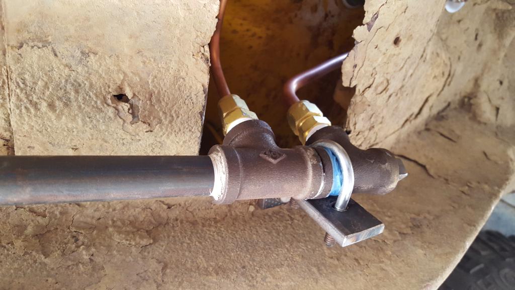

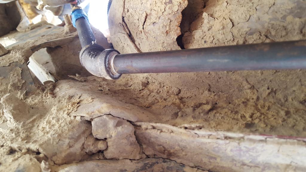

      Under the Jeep, I wanted something tougher than that thin walled tube, so I used a 3/8 x 6" pipe nipple and a 45. I ran 3/8 pipe from there back to a convenienly placed rust hole in the floor. The first tee feeds a 1/4 line up to a pressure gauge in the console. The second is a 3/8 line to the tank.
      A ubolt and simple bracket affix it to the floor. A similar one holds it to the transmission crossmember. No pic, sorry.

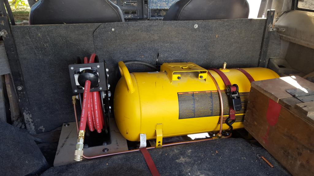

        In the back, my second-hand Dewalt tank squeezes perfectly between the bulkhead and my axleshaft crate, and it's held down with a ratchet strap to eye bolts in the floor.
        The air line (all 3/8 copper) comes up from below the floor, tees off to the top of the tank, and over to a Harbor Freight hose reel. P/N 69266, 25ft, $60. I considered the 50 footer, but weight was already a consideration, and 25 is plenty to reach the whole XJ and anybody I'm parked next to.
        On the front of the tank (doesn't show in the pic, sorry) is another 3/8 tee. One leg accepts the tubing, the other has a 120-150psi switch (amazon, IS-368, $11) to signal the clutch on the compressor. On top of the tank is another 175 safety. The bottom is just plugged for now, I need to plumb a valve and drain line.
