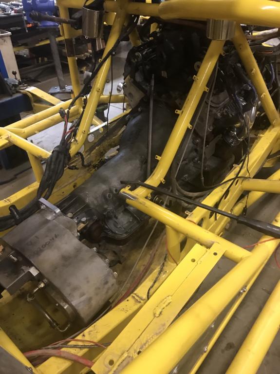

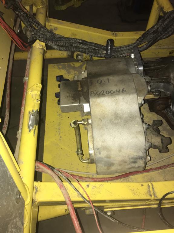

    • #3

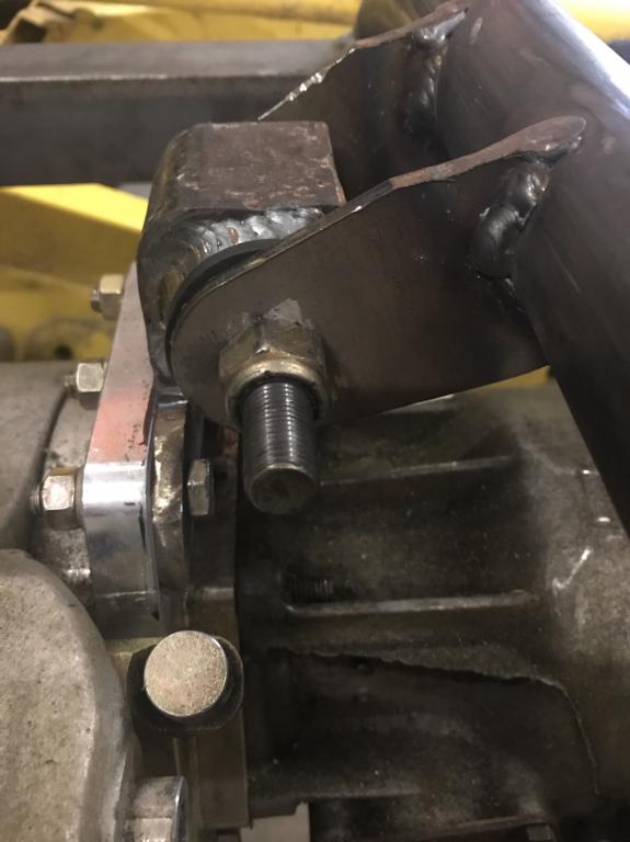

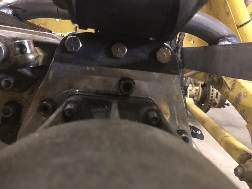

      • #4

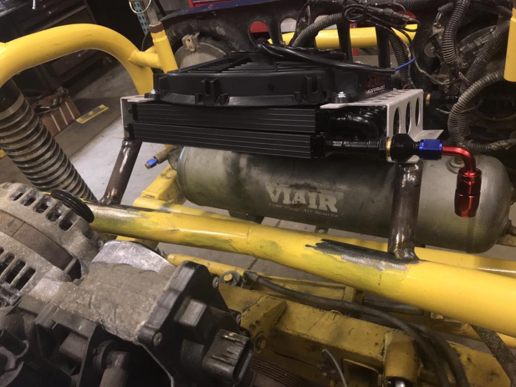

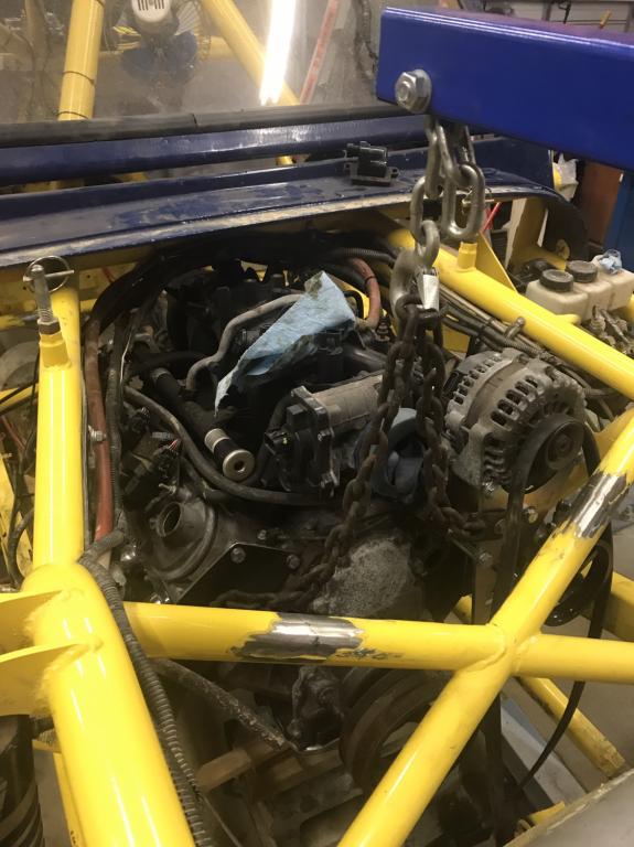

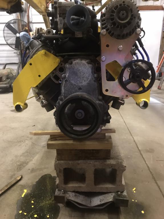

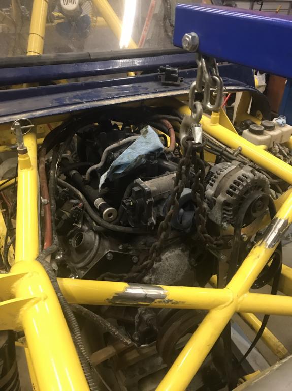

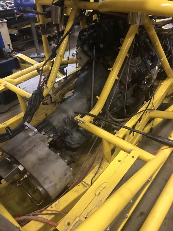

        Looks pretty snug. Any issues?
        Comment
        • #5
          Yep. Coil packs. Gonna look into it tomorrow
          Try to maneuver it better. Zach won’t want hear this
          sigpic
          Comment

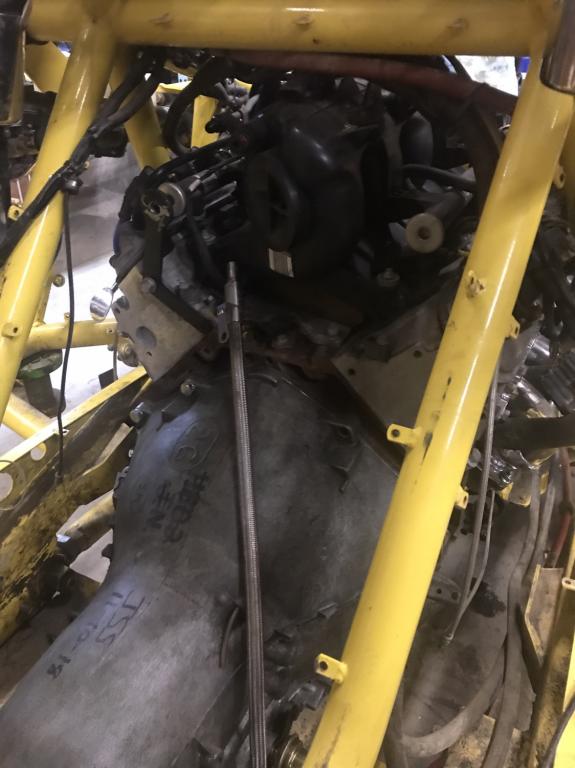

          • #6
            You can always relocate the packs and get longer plug wires. Are they all in the way or just a couple?
            Comment
            • #7
              I mentioned flipping the coils backwards (if that's possibly) and getting a longer set of wires. Lester also came up with a good idea on Facebook. I guess Jegs sells this rack where you can mount and hang them in any location you need.
              https://www.jegs.com/i/UNKNOWN/335/5...MaAiUZEALw_wcB
              Comment
              • #8
                Just one. I am going to stand it up right and make little tabs for it.

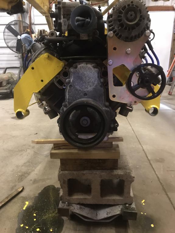

                • #9

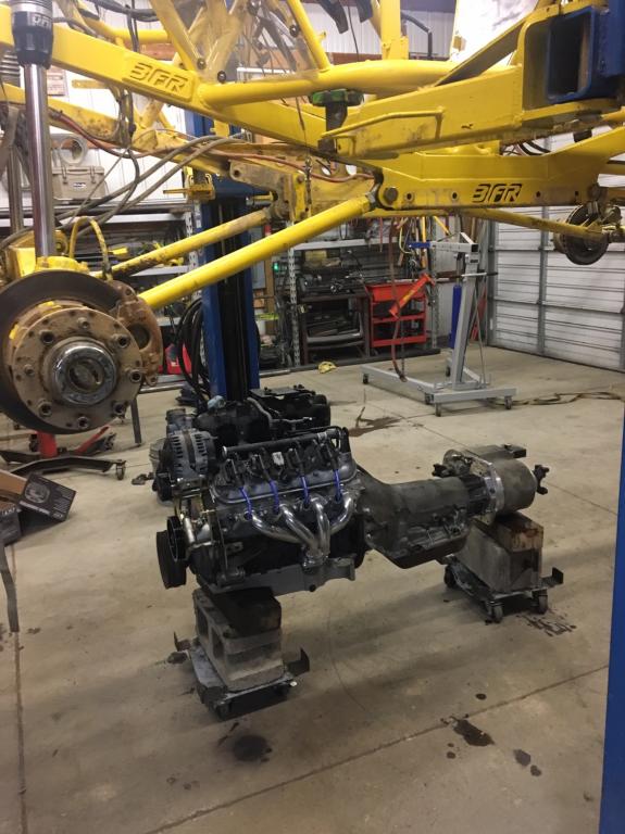

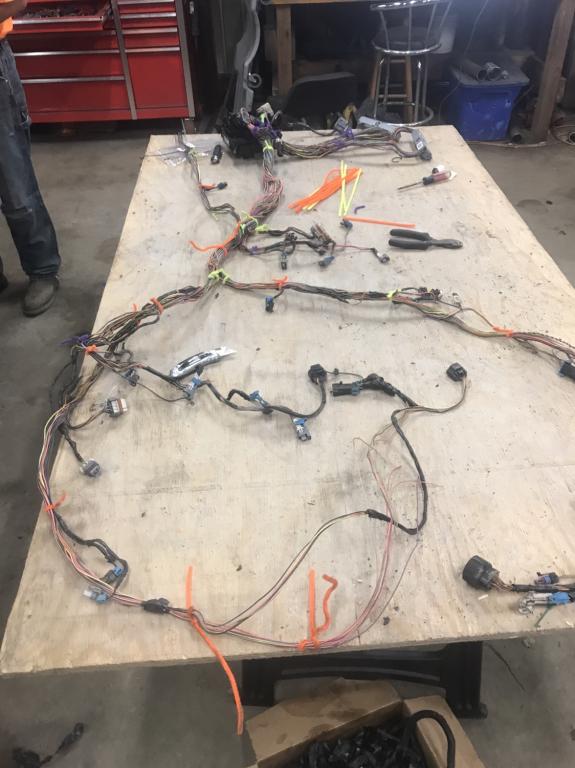

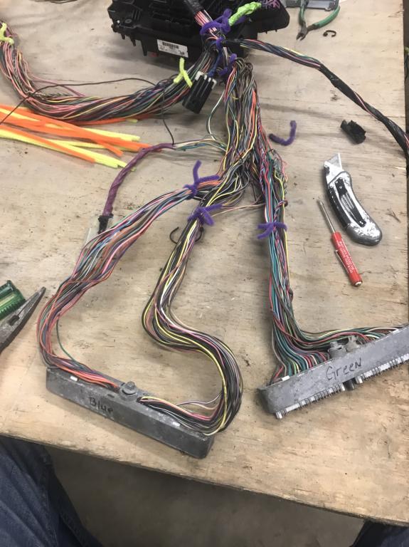

                  • #10

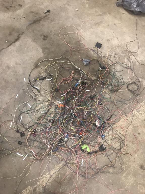

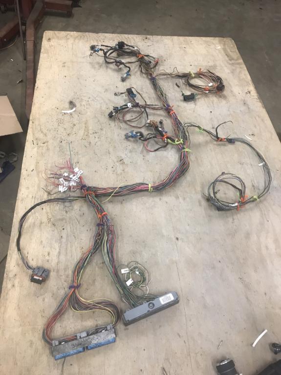

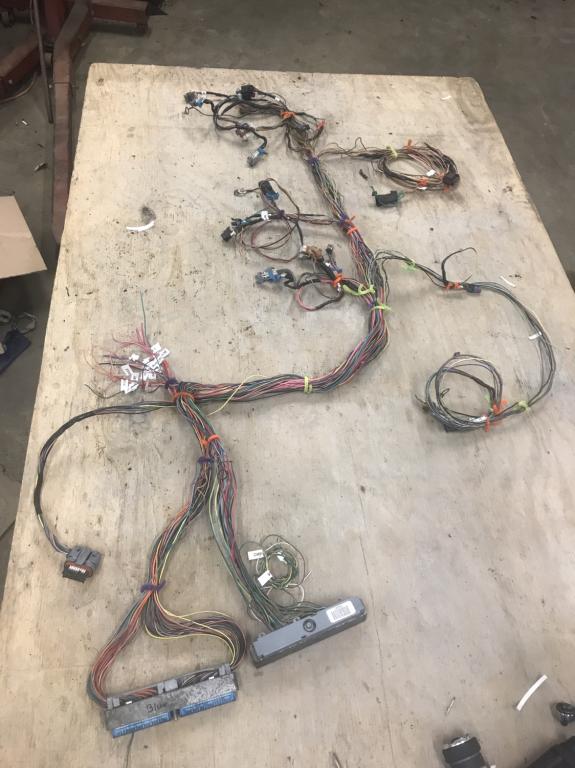

                    Wiring done today

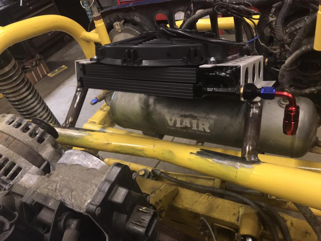

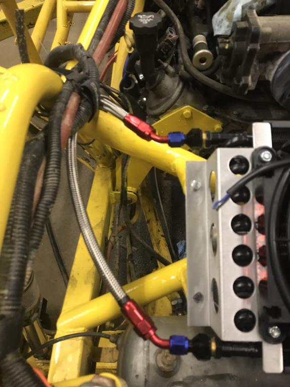

                    • #11

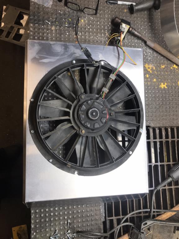

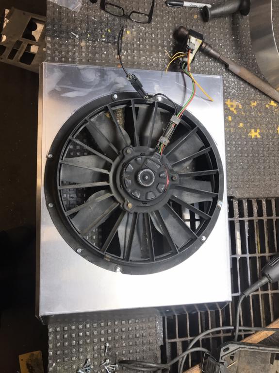

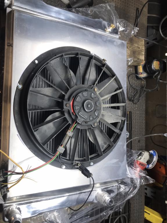

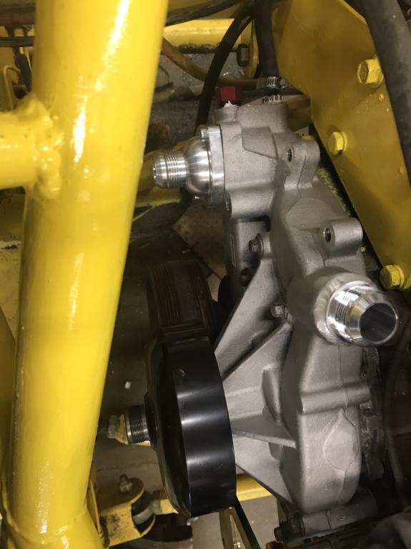

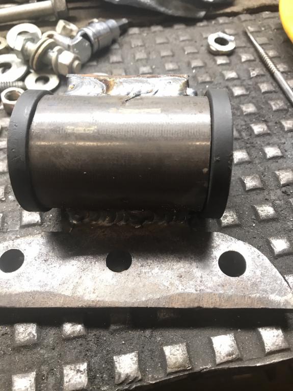

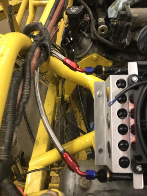

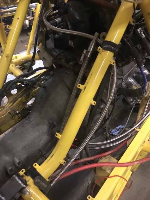

                      Got the water pump tapped for the thermostat and steam port done. Needed a 3/8 and 1/2 pipe die (harbor Freight $11.89)
                      Got the shroud cut out for the Volvo fan as well
                      Ken Garcia did the aluminum welding for me. Doing AN 16 fitting and stainless steel lines

                        Looking good. I have 1/4-3/4 npt taps and 1/2 - 1 1/4 dies if you ever need them.
                        Comment
                        • #13
                          I have 1/4, 3/8 and 1/2 pipe tap and dies as well now
