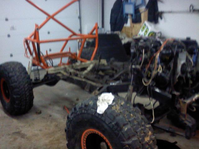

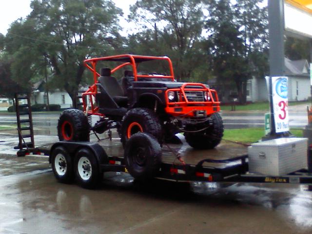

Here are a few pics of my build. I am taking everything (drivetrain) out of my Sammy and putting it all in the new chassis I picked up. Some pics are cell phone pics and are not the greatest. I will keep it updated as I go.
Specs: Dana 44's front and rear, 5.13 gears, 1.6l 8v, stock Sammy trans., Sammy transer case w/ 4:1 gears, 4 link rear, YJ's front, full hydro steering, all sitting on 36" tires.

Got the motor in the new chassis this weekend. I had to order a new rear seal for the tranny so it and the t-case will go in this week.

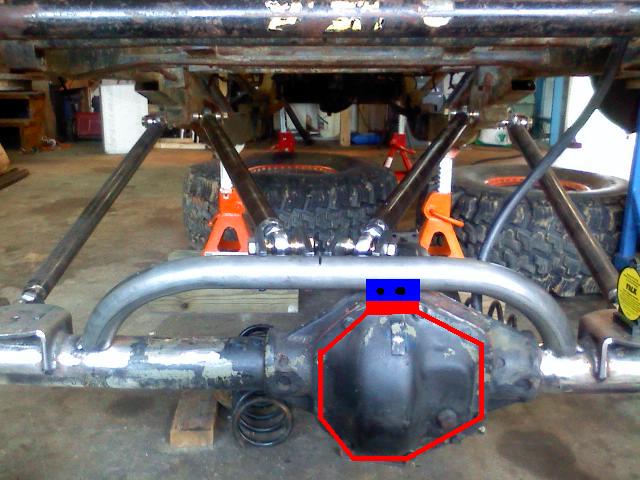

Well it has been awhile since I have updated this thread but I have not had very much time to work on it. I finally got the rear end in. Thanks for the tubing Mike! The rear is pretty much done besides mounting the coils. I am hoping to have the front in by the end of the week.

your gonna wanna tie that trus in somewhere else, or your going to twist it right off.

What about something like this? Basically bend another identical tube, weld it to the axle at 90 deg. and tie the two together...

Or this? I have a couple diff rings that I could use. Weld a tab on the truss tube and bolt it to the diff rig that has a tab on it?

Old 05-13-2010, 08:17 AM   #23
I vote for this as this should be indestrcutible.

be careful about option 1. Remember to plan it so you can still service the diff.
Old 05-13-2010, 08:19 PM   #25
That is where I am at now. I do not know what to do. I am hoping to get it sitting on its own wieght this weekend and then I will work on the details....
