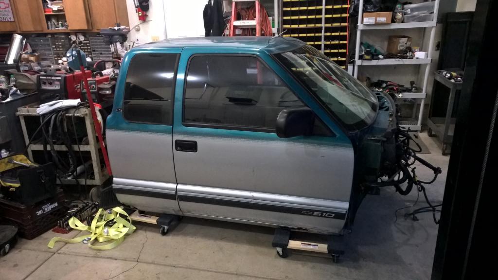

The rest of the truck is gone. Now I can easily roll the cab around in the garage. Time to sort though some wiring and get rid of wires I dont need.

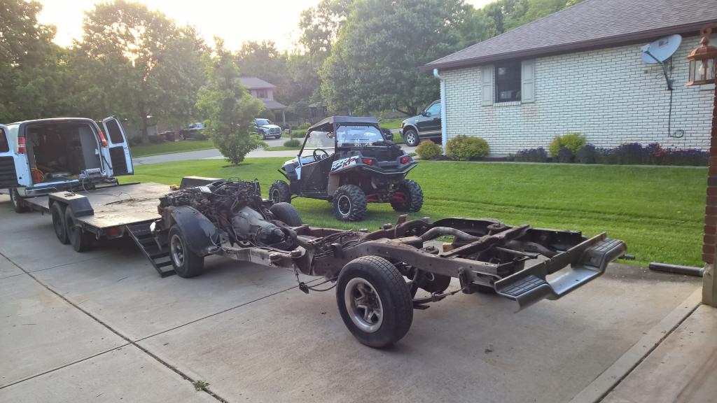

Gone. Hit the scrap yard this morning. I got half of what I paid for the truck. $200

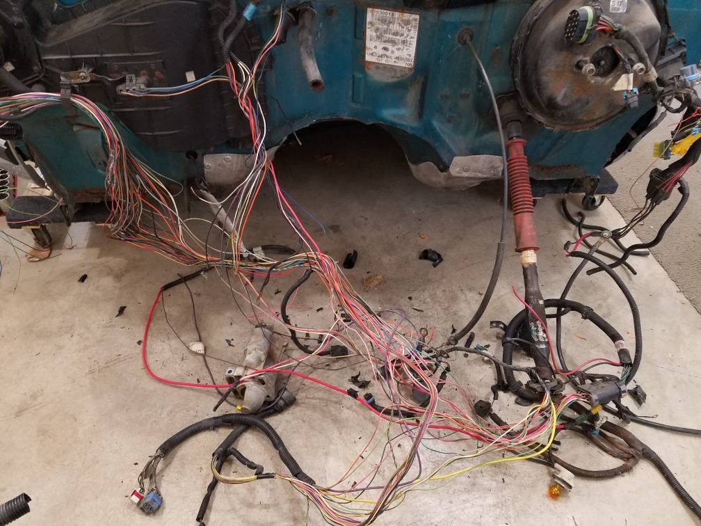

Started getting rid of the extra wiring and finding what i need to hook back up. Most of the wiring will come over with the engine. Once i get the wiring sorted out, I'll start building a frame. Then the old rig gets stripped.Click image for larger version

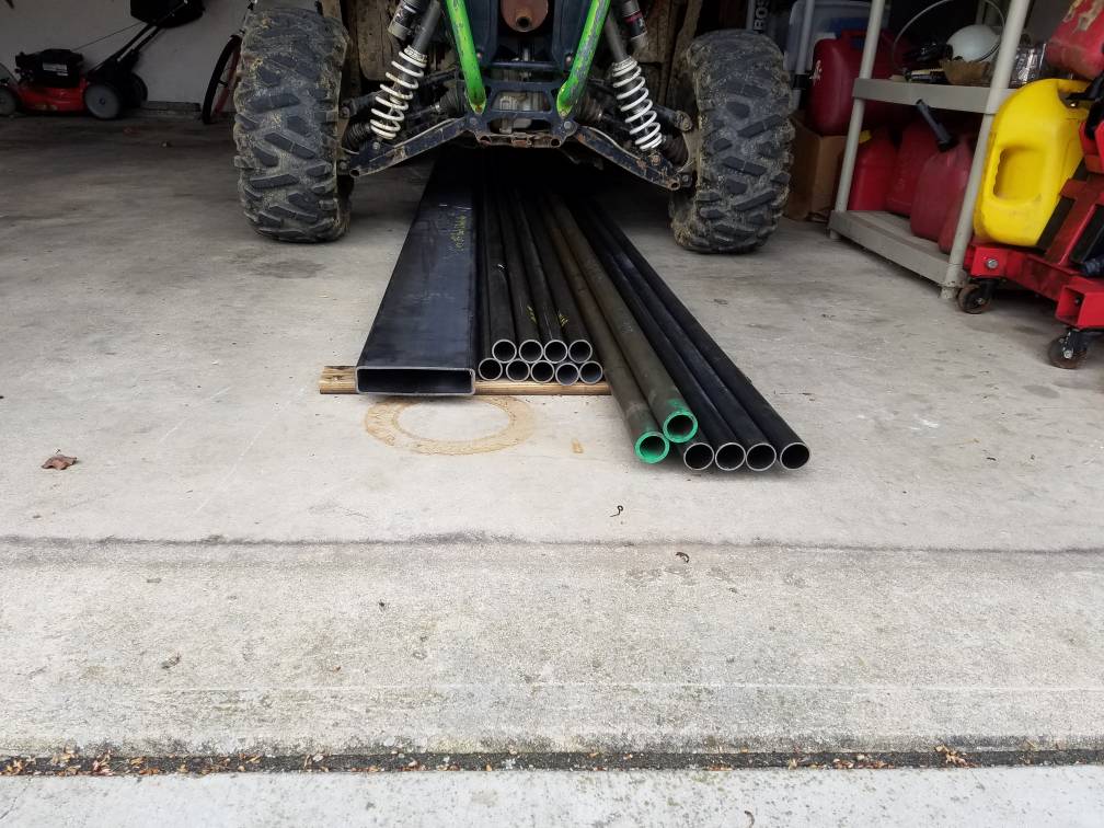

Got all the tubing I need to complete it now. Time to get busy.
