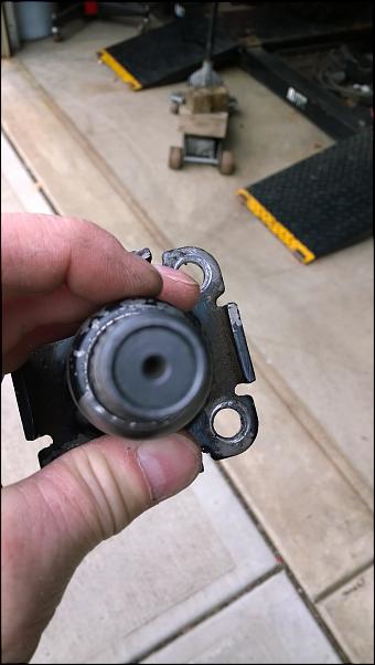

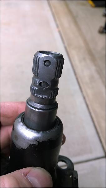

Found the problem. It's the adapter stem on the orbital that the steering shaft attaches to. The splined part is actually a sleeve, and has a roll pin to hold it to the main shaft. The splined piece is pretty thin so it twisted around the roll pin. A few tack welds should do the trick.

I sheared the roll pin that keeps the sleeve from rotating on the shaft. The roll pin ran through the bottom hole. I would've thought the shaft would be splined, and not capped with splines. I welded it up, so I shouldn't have any more issues with it.
