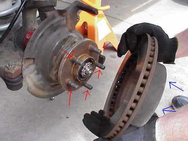

mikeyours
Location: Hamilton Ohio, USA
Posts: 42
hahah lets try this again. the Red arrows "wheel studs" and the part that they are pressed in move or spin when the tire rotates correct? The rotor with the Blue arrows goes over the studs. The Studs are just moving at little back and forth in the rotor holes.
06 TJ Inline 6, 6Speed
4in Rough Country Coil Lift,
33x12.5 SS Thornbirds, 15x10 Crager Soft 8s
mikeyours is offline   Reply With Quote
Old 02-13-2008, 04:42 PM   #31
jfiscus
Terrain Stomper
jfiscus's Avatar
Location: Crittenden, KY
Posts: 633
Cool
All statements above are correct.
However, studs should not move. Ever.
If you can grab and "move" a stud, there is a problem.
The hub that the studs are pressed into should only "spin", not wiggle.
I am in Middletown off Oxford State Road, but if you want to drive up here some evening (6-10pm) this week I would be more than glad to take a look & tell you what is wrong (if anything). My number is 513.967.7091, leave a message with your number if I don't answer. - Jason
