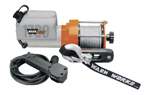

Warn Works 1700-DC
These should work...
$99.99 from Northern Tool right now... Can't beat that price.
Some specs:
Pulling Capacity: 1700 lbs.
Switch Type: Remote with 12ft. lead
Motor: Permanent magnet, 3.0in. diameter
HP: 1.6 HP
Power: 12V DC
Gear Train: Split ring gear
Gear Ratio: 153:1
Clutch: Knob-pull and turn
Brake: Self-locking gear train (rated load holding) (as opposed to the disc brakes in the ATV winches, I like this better..)
Wire Rope: 3/16in. x 35ft. (will be replaced with 7/16" or 3/8")
Drum Diameter: 1 1/8in.
Fairlead: Hawse
Hole Pattern: 2 holes on 3.1in. center
Electric Leads: 2-6ft. x 6 gauge cable
1-year limited warranty
U.S.A.
Model 651700

work ok upside down you think, any issue?
Old 04-03-2007, 12:03 PM   #10
Well, they won't be 180 degrees upside down... more like 90 degrees sideways... I can't see any issue other than possibly water drainage?
Front will be under the hood, and I'm thinking that I may get an ATV style cover for the rear one...
The drum diameters on the Warn Works series seem to be slightly smaller, but for what I'm going to do with them, I'm assuming that they'll be fine...
