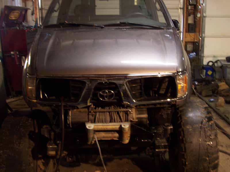

tacoma truggy build
1998 tacoma.leafs in the front with toy axles,4 link and fox 2.0 rear.22r on propane.

cool, I dig it...
Old 01-28-2010, 06:34 PM   #3
hotrod
Diesel guy
hotrod's Avatar
Location: Bridgetown
Posts: 241
nice

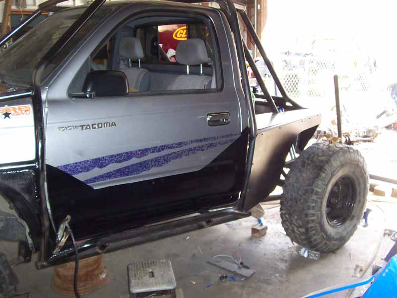

Posts: 297
Wow, that rear is bobbed really short. Looks good though!

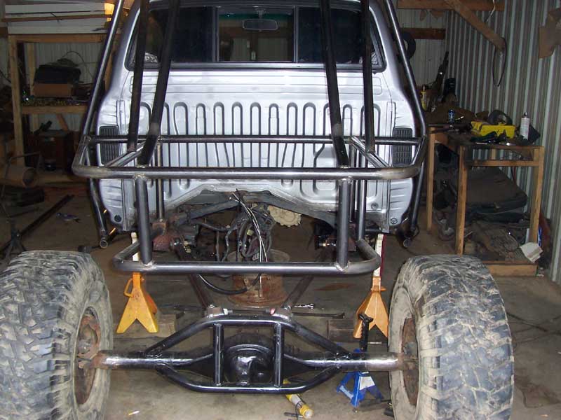

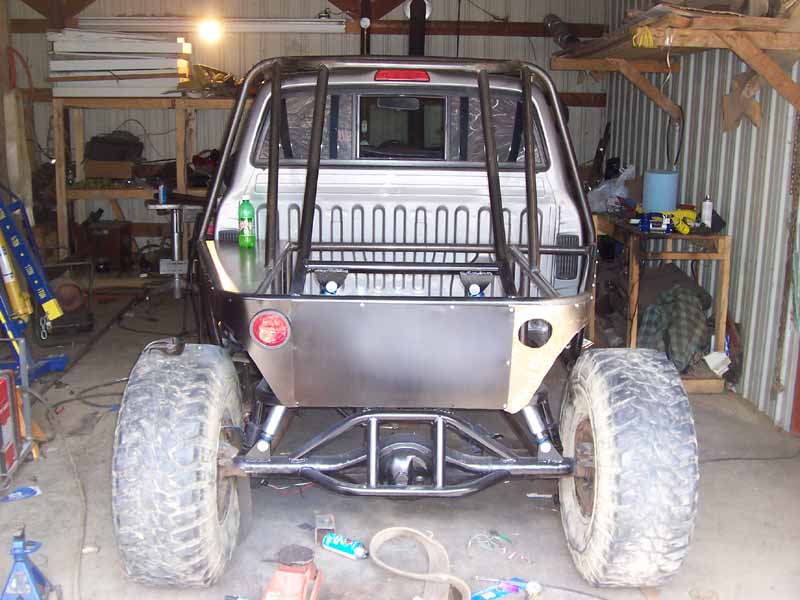

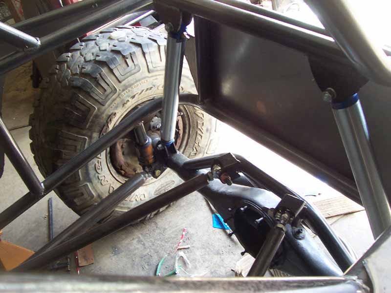

Old 03-22-2010, 05:55 PM   #15
I have a comment on one little aspect of the cage... Take it or leave it, it's just a comment...
If you were to "apply downward force" to that top bar (like rolling on your lid, for example... not that it will happen, purely hypothetical ) that little bend in the rear-most diagonals would give the force a direction to bend those diagonals... and they are going to bend toward the interior of the bed (and your "stuff" in it), while taking out the nice shocks... anyone else see this?
Hate to sound pirate-ish, but more triangulation?
Overall, I really dig this build... great stuff...
Old 03-22-2010, 09:41 PM   #16
that was the exact thing that ran through my head brad. some sort of brace on that tube i think would be a good idea.

Posts: 34
i dont have all the bracing done in the rear yet but thanks and keep them comming.

Old 04-28-2010, 03:46 PM   #19
Oh yeah, I like that MUCH better for that area of the cage that I noted...
Are these roller tires/wheels... (or is it camera angle?) They seem really close to the rear bumps on both sides... (as if one dropped, the other would be dragging the bump)
Nice clean design, I really do like it... I just ask too many questions...

Posts: 34
yes those are rollers,it will have 37 boggers on it.its bumpstop at 6 inches of up. wanna keep her low as i can.

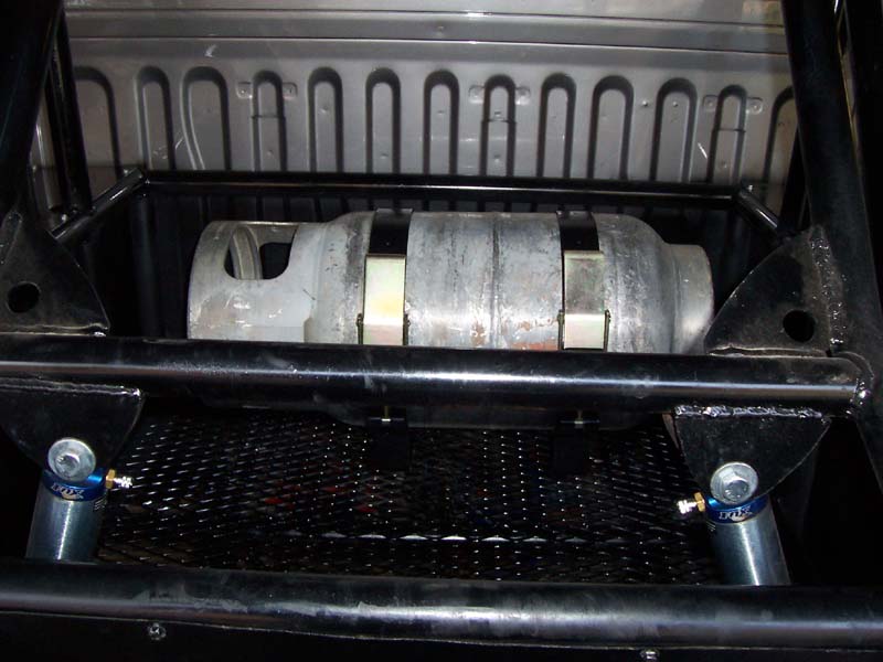

Old 04-29-2010, 11:37 AM   #21
I can appreciate keeping it low... guess I was talking about the sideways distance to the tires... if the wheels that you're going to run have less backspacing I would think that you'd be fine, but I'm looking at this...
Just feels like flexed out to one side, the opposite side would be dragging the bump or bump support... could be camera angle though...
If you're gonna keep a tool bag behind the Propane tank, would it make more sense to turn the schrader valves of the shock outward? (I was riding with Butch once when a freak tree branch came down and popped the schrader valve off... talk about surprising... )

Posts: 34
the 37s have 2inches less backspace.and there is a plate thats not on there yet to block the valve.
