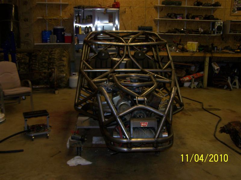

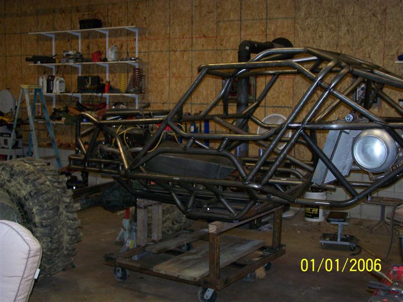

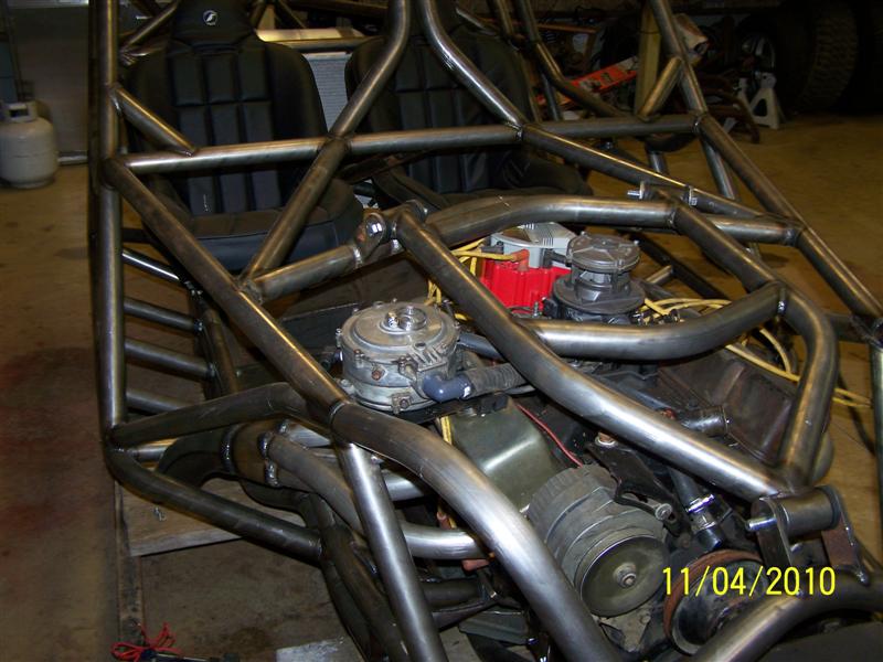

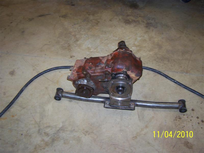

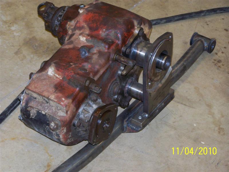

Been busy, got married 2 weeks ago and went slade wheelin for honeymoon! I got propane regulator on and got 205 almost ready to go in the last couple days.

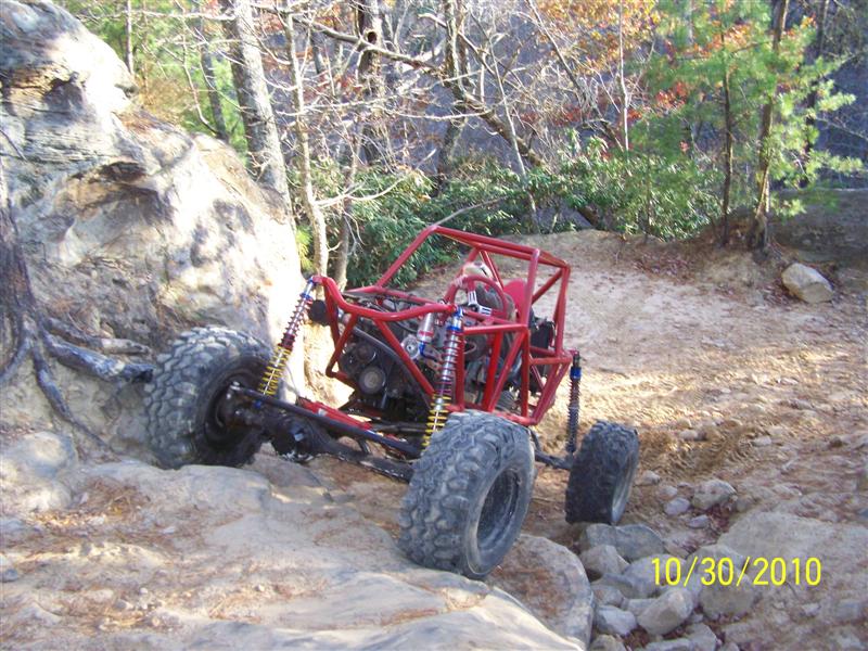

couple pics of wife playn on hairpin in her buggy

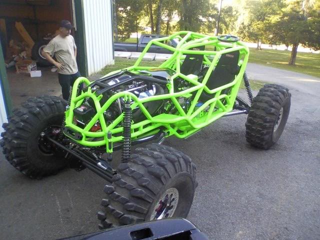

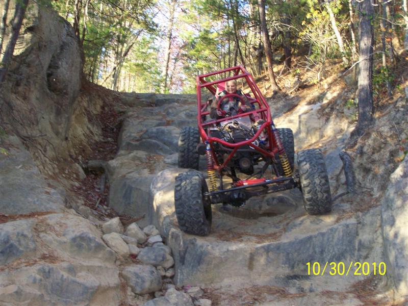

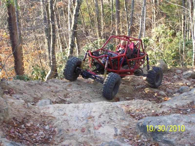

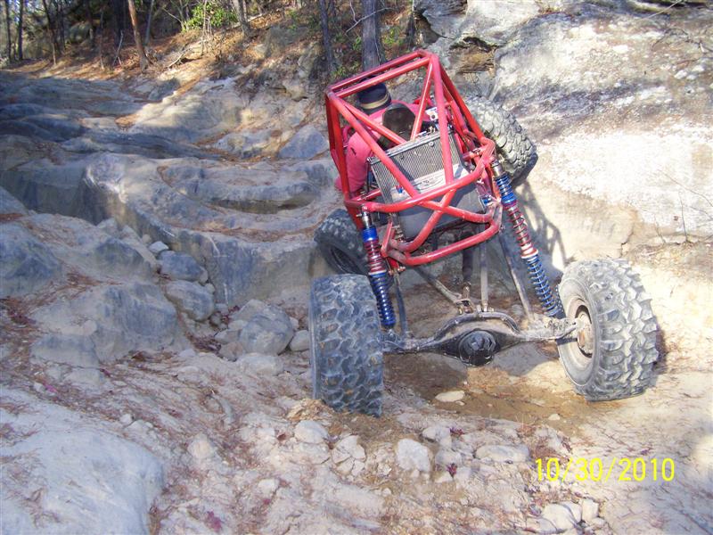

cost few hundy. her buggy has 113wb with yota axles, zuk tcase 6.5.1, tracker 8v engine with cam and HD carb, auto tranny, fox C/O's. got main chassis from Bent Fab out of Lexington

dude i love the mount for the 205....thats slick...and simple!!!

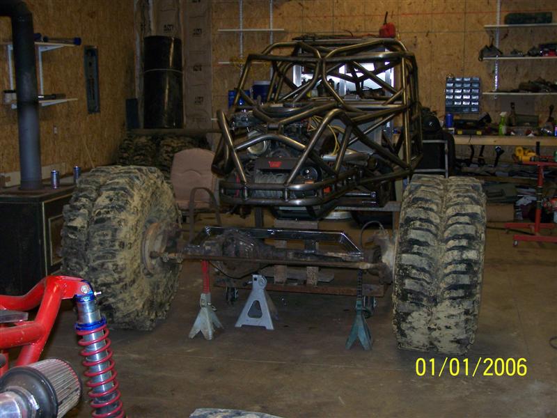

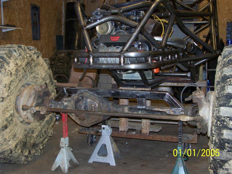

got truss for 60 built 2.5 1/4 wall tube for truss. got front in place, ordered 1.25 heims and misc. brackets from polyperformance and ruffstuff speciaties. Now starting on rear truss today hopefully

Old 11-19-2010, 02:45 PM   #40
lookin good. what radiator is that? ive been lookin for one with a flange to mount it with on top like that one. got a model number?
i like the front truss. is it welded to the cast center section? any special prep on that?
lookin good!
Old 11-19-2010, 03:14 PM   #41
not sure on radiator, it is an Afco though. Yeah it welded to center just took torch and heated cast real good b4 i welded to it. I made truss long so it be dual purpose so my air bumps will contact it also

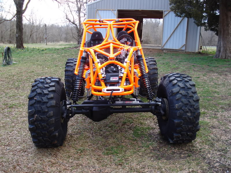

running 17"bilstein coilovers,bumps will hit top flat of truss and c/o will mount on the angled down part of truss. think pic help

my truss is very simular to urs, airbumps bottoming on the top and shocks mounting almost on the knuckles. very simular.
im about at the same part of my build as you are, keep postin pics and im sure i will swipe some ideas:)

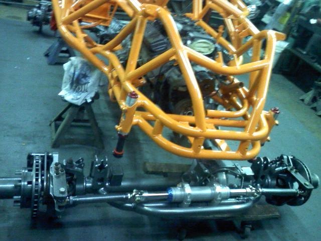

couple different ideas, on suspension. Jimmy Penner on eor built Tc's green Smith buggy suspension
