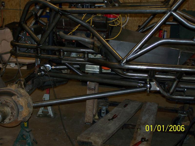

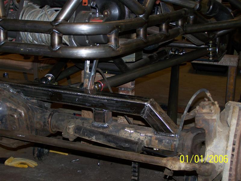

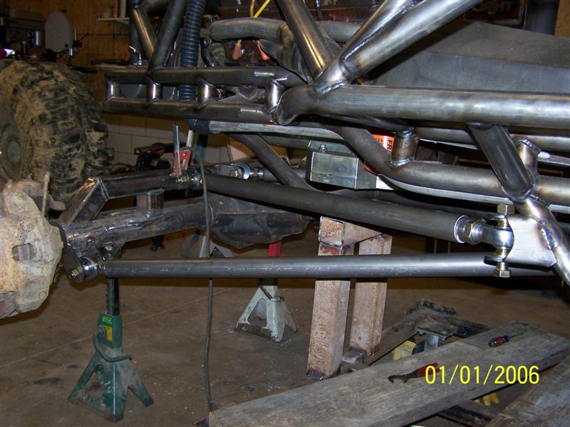

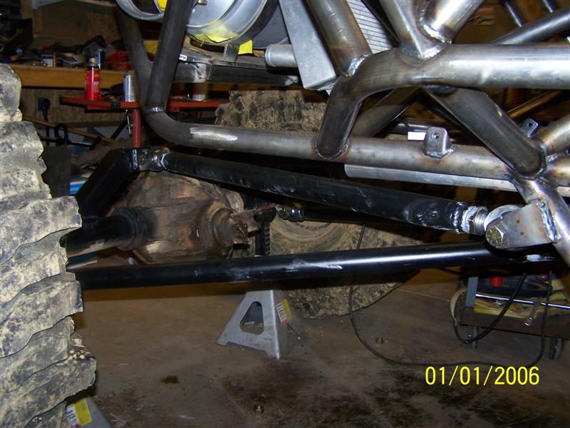

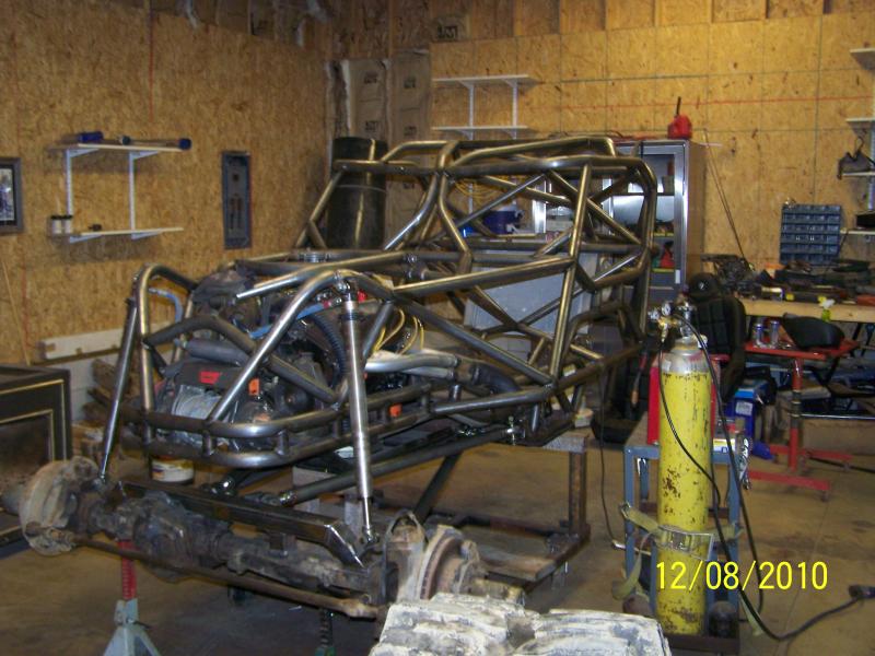

no most jimmys buggys are small blocks 383, 406, he had a fourseater with a 434 in it. I doing four link, i hav built quite a few rigs suspensions and he pointed out few things to help out. got few things today and got front suspension tacked in place

do you have anymore pics of the upper link frame mount? is that one piece you bought or did you have to box 2 together?
Old 12-06-2010, 08:28 PM   #56

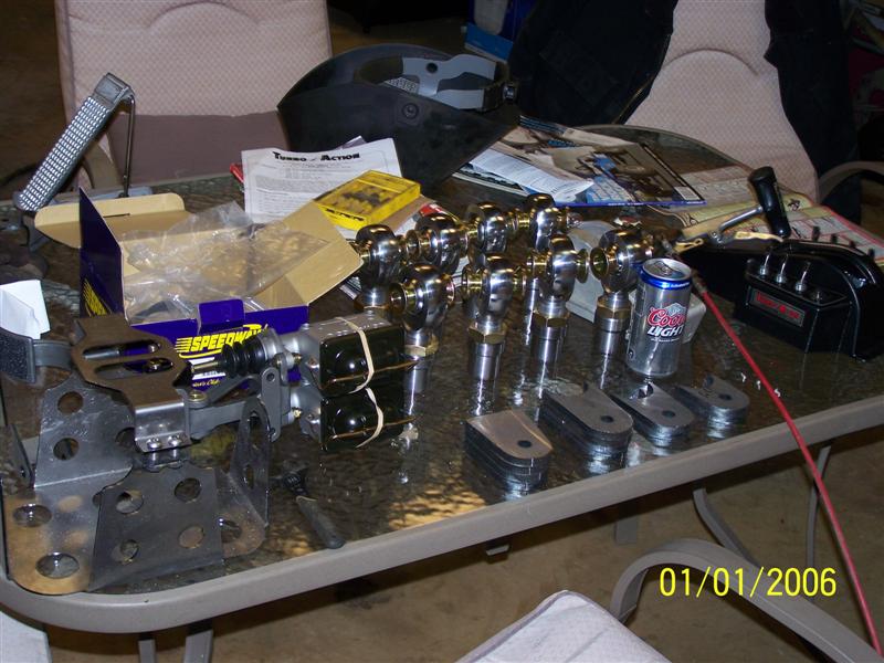

it is the 22.5 degree 1.75 mount from polyperformance modified to fit frame
Old 12-06-2010, 08:30 PM   #57
where that battery box come from?
Old 12-06-2010, 08:55 PM   #58
battery box, heims and 3/8 tabs came from ruffstuff speciaties
Old 12-06-2010, 09:40 PM   #59

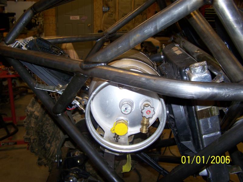

Looking good man!!! I'm liken the four link set up, looks nice clean work. I must of been mistaken, i was thinkin they ran alot of the 502's, Maybe i'm thinkin of coleworx.. Maybe you said it, and i didn't read it, but you building the propane set up, or is it a kit from somewhere?-Chris

Old 12-07-2010, 06:14 PM   #61
sure you have enough vertical seperation on the frame end? looks like its going to want to lift under throttle? on 2nd look, maybe it is just the camera angle?
Old 12-07-2010, 06:53 PM   #62
hard to tell with the camera angle id say...
im wondering about the upper heims mounted sideways...?
paint vs powdercoat i think depends on how hard you beat it... if you really plan on tearing it up on your side in the rocks id def stay away from powdercoat. harder to touchup, scrapes off with a divot, ect...
either way, looks good. if welds are pretty, i like the clearcoat idea.:)
Old 12-07-2010, 09:22 PM   #63
positive, 4inches verticle on frame end 9 on front axle. got heims sideways off Jimmy Penner of Eor. clearcoat i think look good, welds are slick! as long as i dont f them up!!
Old 12-07-2010, 10:20 PM   #64
that's teh same as i'm running, and it works great. definitely the camera angle. it looked like they were mounted on the same plane or with maybe an inch.

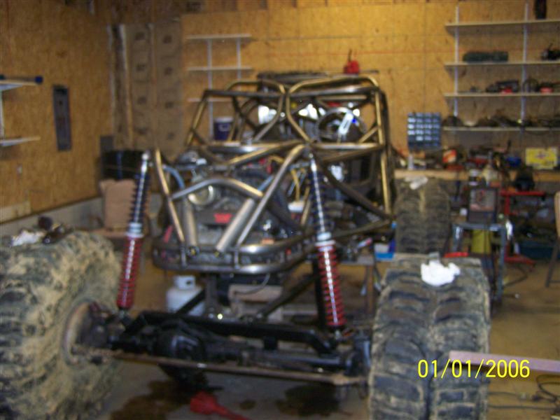

Old 12-08-2010, 04:30 PM   #65

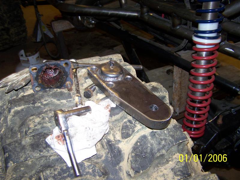

got shocks mounted and battery box under seat mounted

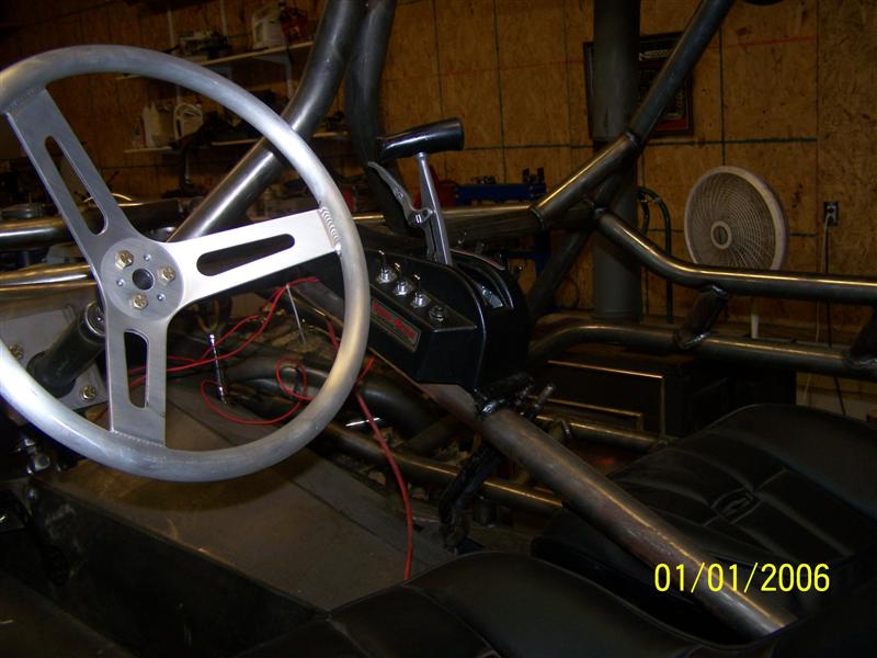

Old 02-19-2011, 07:43 PM   #70
race10
race10's Avatar
Location: oxford
Posts: 179
I might have over looked it but what's the inside width?
Old 02-19-2011, 10:11 PM   #71
Hey am i seein that ur shifter has built in toggle switches? That a art carr winters rock gate shifter?
Old 02-20-2011, 08:42 AM   #72
its a prostick with a shifter console from jegs that has push button start and 9 toggles on it. Been meaning get sum pics been slacking on keeping it up to date on here. i get width too
