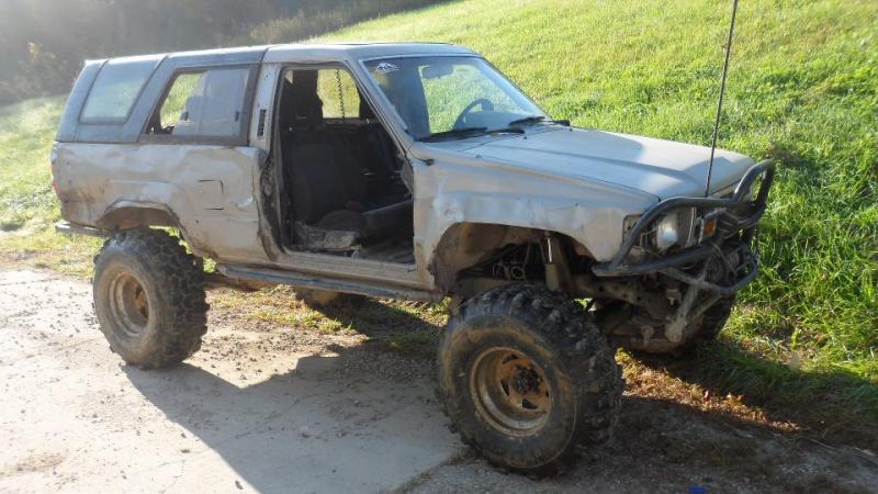

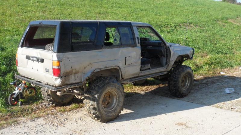

i will post up some pictures of the spring set up here soon, here s some of what I ve got now. some more info as well.
85 front axle
86 rear axle
36 tsl bias
high steer
trans case regeared to 4.7:1 low
4.88s with lockrite front and detroit rear
22RE
better than stock birfields

Old 10-13-2011, 07:42 AM   #6
Hotwheels
Hotwheels's Avatar
Location: Maineville, Ohio
Posts: 125
Runner looks good I sent you a PM
