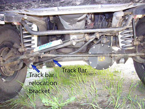

this is the bracket i am referring to as the re location bracket.do i need to keep it or can i get rid of itand use the manufatured oem location.

I am using a clayton Track bar with the Clayton Drop Bracket on the frame side. I have a 4" Drop pitman arm on right now and I am going to try a 3" Xj pitman arm to get the angles correct. If you are using the Clayton drop Bracket with the track bar you are going to need a drop pitman arm. If you are using a clayton Track bar with the factory track bar bracket you probably will need a factory Pitman arm. The angle of the track bar needs to be as close to parallel to the angle of the drag link. Measeured through the mounting points. I would not use the axle drop bracket you are using. Clayton is also very helpful with tech questions about there products. I just sent them some pictures of my setup yesterday with some questions they were great help.

Looks like the angles would improve with the axle bracket in the factory spot

X2.... The purpose of an adjustable track bar is so you can use factory mounting holes on a lifted jeep. I would say that's where your wobble came from since your track bar and drag link aren't parallel anymore. Take that ***** off and use the factory hole with the new track bar and DPA, 4"
