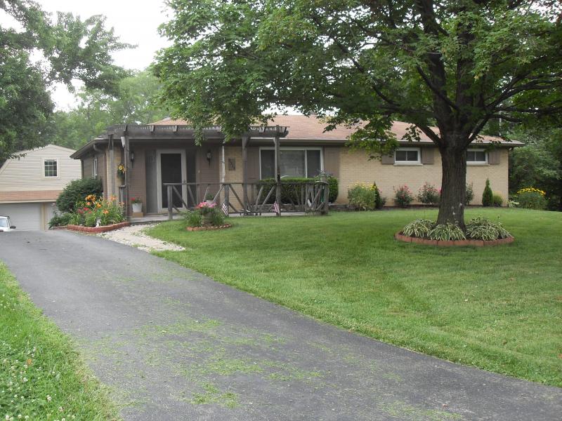

I'd be interested....
I think you should look into something like i did for my upstairs... it sure is nice having a big room up there... Thought i had a better pic, i will get one tomorrow...
