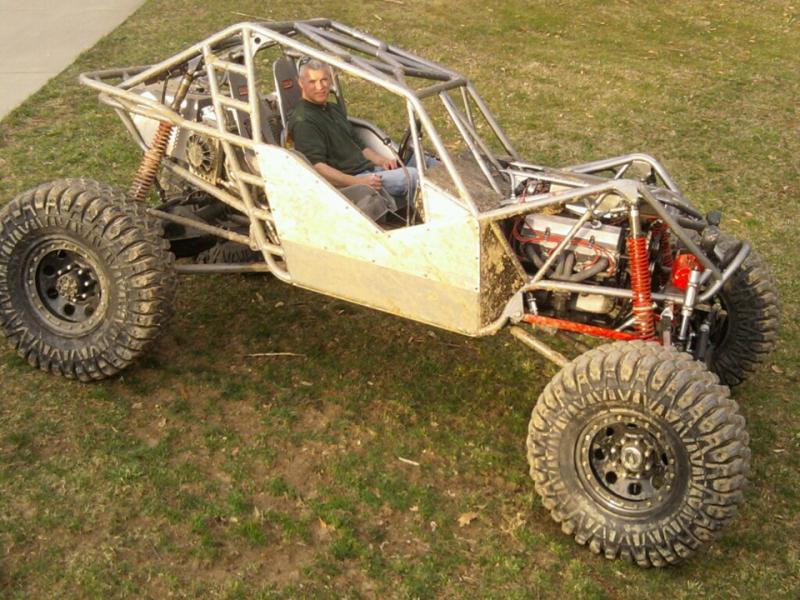

I think a commonly accepted loss through the drivetrain is about 40% on these big tired offroad vehicles. It put down 241 rwhp so thats about 400 hp at the crank. Not bad but I was expecting a bit more. It'll get the job done.

40%???? I think that's way to high. I've spent a lot of time around engine and chassis dyno's and never seen a 40% loss of power. If your putting out 240 Hp at the wheels the motor is more than likely pushing 300-325 max. Should be more like 20% loss. The transfer case and large tires won't make up an extra 20% loss. Granted automatics lose more than manuals but its a difference of say 7% -10%.
Old 03-31-2013, 10:05 AM   #74
underpowered
They call me......Scuba
Location: Burlington, KY
Posts: 292
as a rule of thumb i was always told by dyno guys a manual has 10-15% loss, and an auto has about 20% power train loss.
40% does sound very high even with your big tires.
beat up rusted out k5
Old 03-31-2013, 06:13 PM   #75
I drag raced for years and spent lots of time around chassis dyno's as well. As an example there is a thread on Pirate where one of the Ultra 4 guys posted up his flywheel numbers and at the tires. Both verified on a dyno. Difference for him was 37%. Top of the last page of this build thread.
http://www.pirate4x4.com/forum/gener...a4-car-23.html
The engine in my buggy is a 406 with Brodix heads, Holley Stealth Ram injection and a fairly large flat tappet cam. It better have more than 325 hp or something is seriously wrong. You'ed be surprised how much power all this heavy weight drivetrain sucks up. Wanna race?
