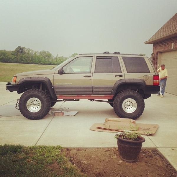

It would be cool to get a pic of the cousins side by side when you get it rolling.....
We have to get all three together for a family pic lol. We did 6in long arm, cut rockers, frame stiffeners, built front and rear bumpers, v8 swap, rear dana 44, spartan lockers front and rear and 35in mtrs. It's 98% done will be heading to Harlan in a few week for a test run

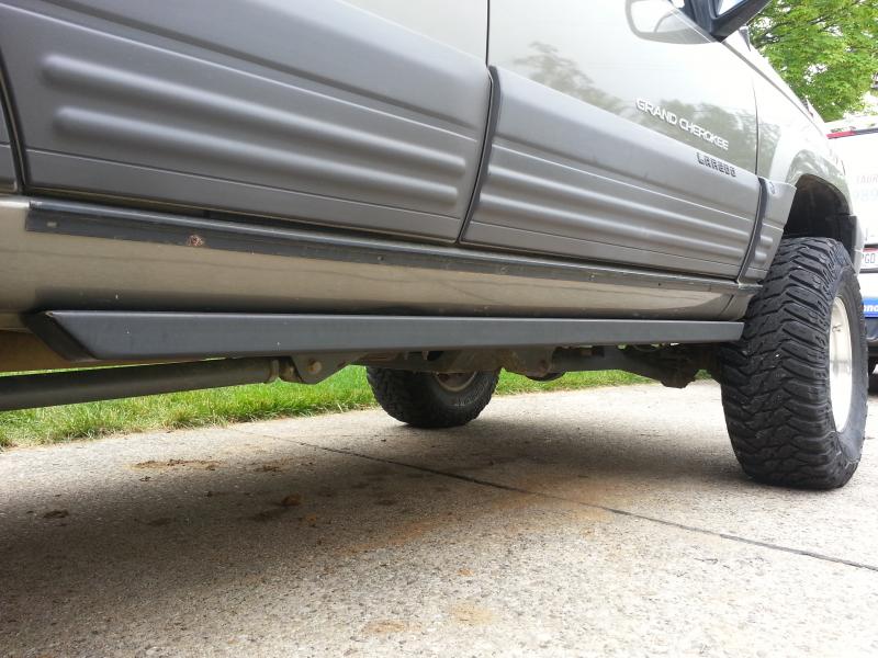

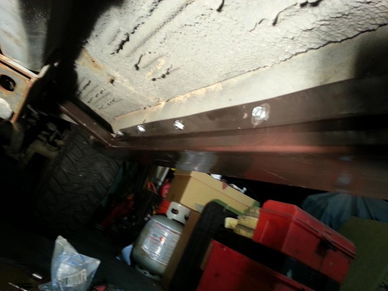

Whacko, you did the Rough Country kit also? Love the wheels I finally got my rocker guards on last month after welding them up last year Couldn't believe it but could actually feel that the grand was stiffer with them.

Didn't take profile pic yet but....
Name:	grand rockerss.jpg
ID:	6769   Click image for larger version
Name:	grand rockers.jpg

Ok I'm bored....
Name:	profile grand.jpg
ID:	6771   Click image for larger version

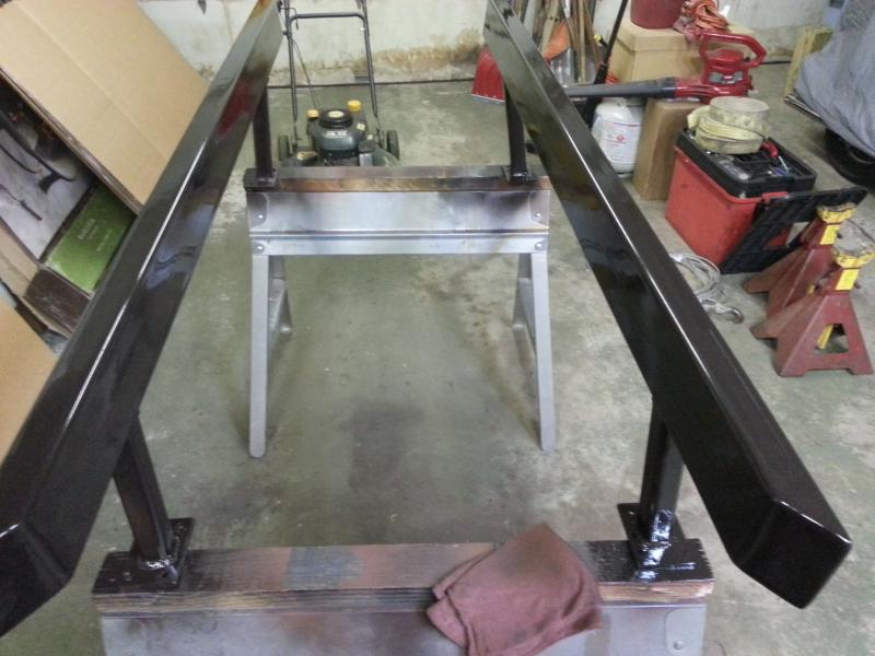

Finished the rear links today. Ready to put on some brackets. Hopefully rear will be done soon. Still have some spring issues. But things are moving nicely for how busy I have been

Looking Good! should be pretty stout but then mine are 1/4 wall dom and I managed to bend a lower rear last year.......
