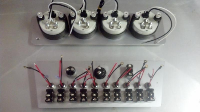

Got the gauge and switch panel made. It's getting there!
ID:	6715   Click image for larger version
