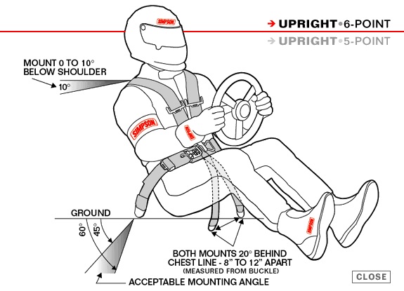

Old 01-19-2014, 07:48 PM   #5
2" harnesses be safer than 3". As far as the lap belt portion goes anyway. And just pay attention to how u mount them as the majority of people have them incorrectly.and make sure your seats arent "gangsta leaned back" if u really want to protect yourself wnen your strapped in. Dont buy used.

Biggin I am talking about safety harnesses like 4pt 5pt etc.
Yellow jacket thanks for the advice on mounting but they are in the buggy with fixed back seats and I'm not so sure on what you mean on mounting them wrong?? I'll look into jegs I know the cam locks aren't good offroad either

Belts mounted incorrectly can drastically reduce there effectiveness ...
Old 01-20-2014, 07:58 PM   #10
Mounted incorrectly will also crush your spine lol
