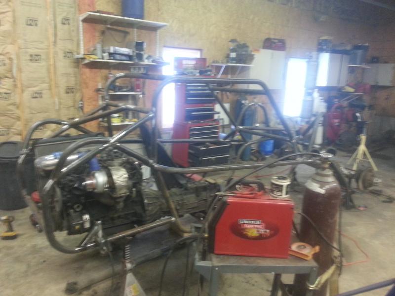

so got bored and startd another buggy

cool design... i have a friend with a rear engine single seat yota buggy... the thing goes everywhere...
I'd like to built something like either of these but with a little turbo diesel...
Old 01-29-2014, 03:42 PM   #3
yeah that perdy cool! there enough room in chassis for a sbc if wanted, but i had most parts laying around garage and got sum 38 sx for tars. think i got 7 sticks in this chassis

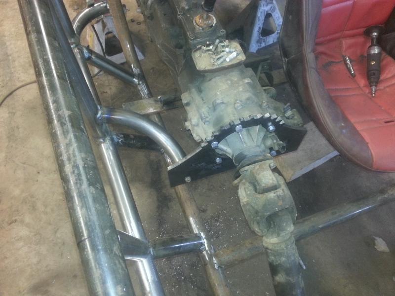

Excuse my ignorance, but doesn't the engine (and the tranny, tcase, and driveshafts) spin the wrong way? Is there a reversing gear somewhere in the drivetrain?
Old 01-29-2014, 08:04 PM   #7
flip thirds 180 is my plan. shooting for bout 110" wheelbase and sum 4.7 gears in tcase to help the 22re
Oh, cool. Didn't know you could do that.
Learnt somethin! Thanks!

what turbo setup are you going with derek?

Jordan it has a air research t4 with 8psi wastegate rite now, wanted to giv it sum motovation! Humpy that sounds like a jeeper fo sho! extreme did the low budget pimpin style chassis, which is what i thinkin on building next, using honda motor and transaxle or mayb ecotec,but that b after i sell this

they can be flipped in the housing, how ever not recommend for i
high speed. the oil slinger is in wrong location.

Twisted looks like it would be hard to shift the gears facing that way!

nah just unique shift pattern! all need is 3rd n reverse
