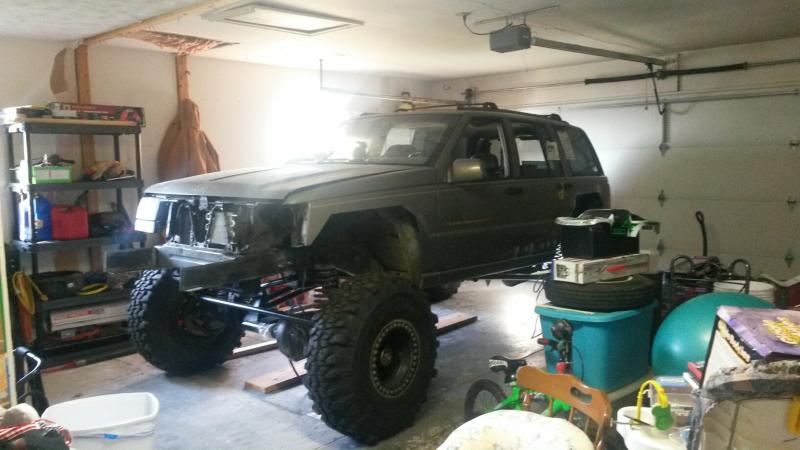

Old 10-26-2014, 10:59 PM   #111
cmartin
cmartin's Avatar
Join Date: Feb 2011
Location: miamisburg
Posts: 191
Got the jeep over to the new house last week. Gonna get all the steering plumbed,fuel buttoned up,and battery lines ran to the back. Start of the to do list.
