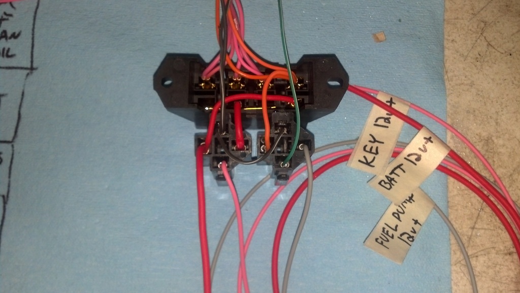

The guy that built the one in this pic does all kinds of harness building. The main wire feeding the 30 amp relay looks to be a #10. He only has 4 fuses, a fuel pump relay, and the switched main power relay. I see this all over the net. I don't see anyone running big wires to run the engine harness. Maybe they are wrong, or maybe I'm over thinking this...

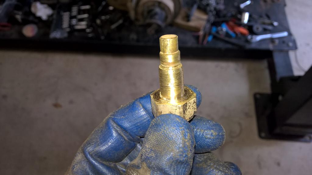

Getting my stock gauges to work was a pain. The stock 93 temp sender is 1/4" NPT, and the 04 is a 12 x 1.5 thread. They make an adapter, but everyone complained that it suck out so far that the reading was off. I saw one guy took the stock one and milled it down and threaded it to fit the 5.3 heads. So I did it that way. Worked great. I can use an adapter for the oil pressure sender.

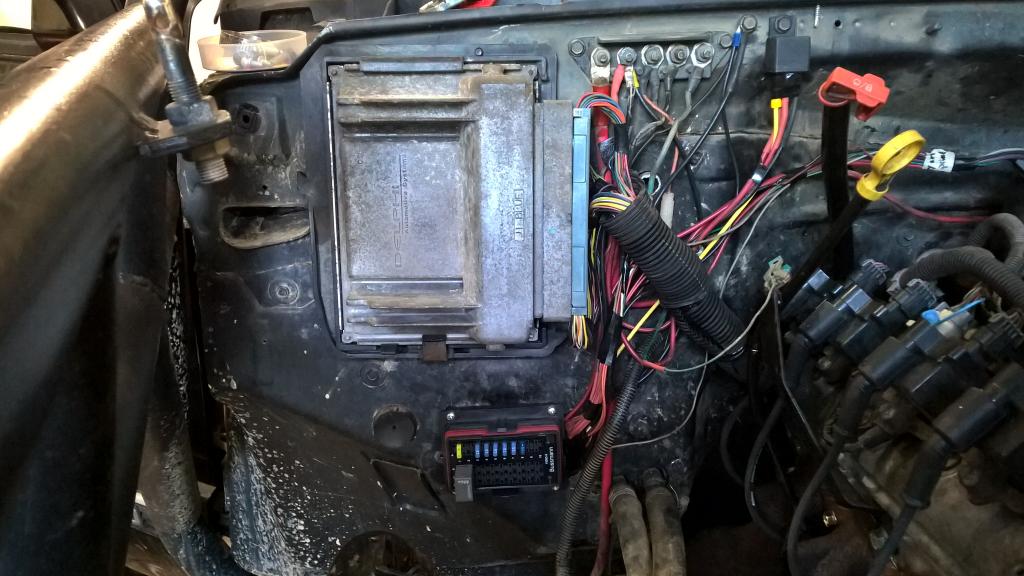

Removing the over flow bottle left a perfect spot for the ECM. The fuse block fit perfect over the spot where the old pcm wires went through the firewall. Now I need to find a smaller coolant bottle to mount.

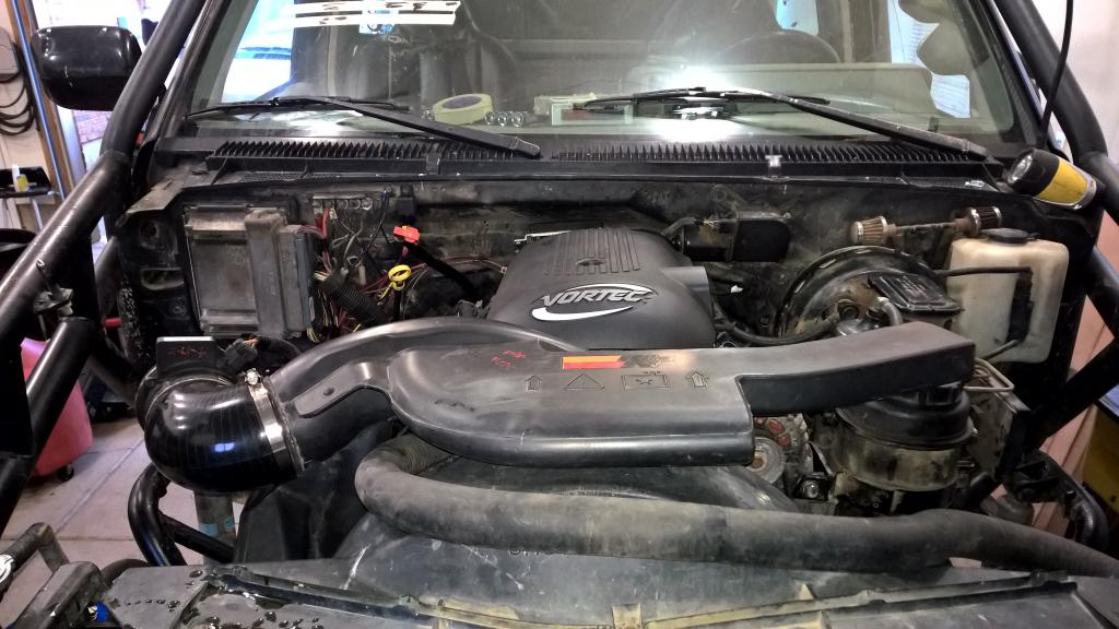

Made some good progress thanks to Waffle coming over to help. Got the exhaust done, steering lines back on and filled, radiator in and filled, trans lines ran, and then the best part, starting it up. Runs great. It's throwing an engine code. The MAF circuit is low or something like that. Hooked up the scanner and it says the IAT temp is around 230 degrees. That is way off. The engine didn't have the MAF sensor, so I got one from u-pull. It looks like it needs to go back. Still have to make a better air intake duct. The stock one is too bulky. There is a lot of little stuff to do now. It will be back on the trail real soon.

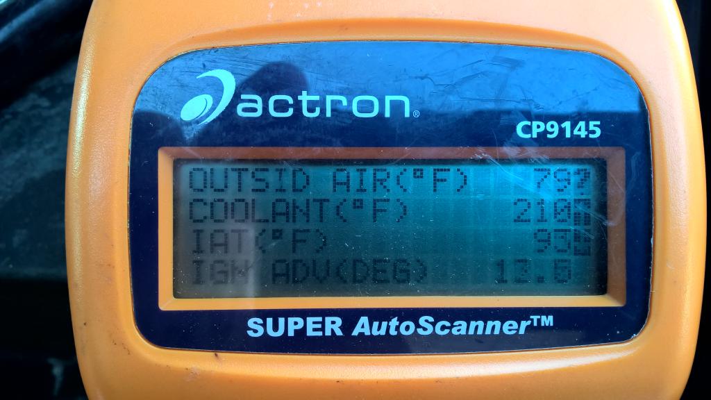

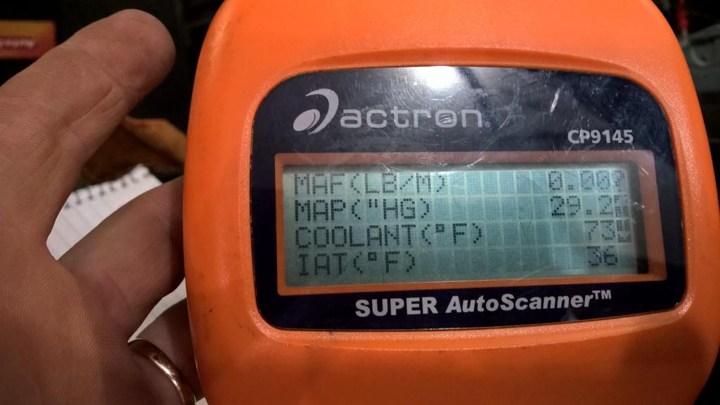

Does anyone have a clue as to why my IAT is reading is so low? It's not the MAF, I've switched it with one from a different vehicle. Mine also reads correct on that vehicle. The temps shown are basically room temp, key on, not running. I checked the MAF temp and it was 74 degrees. At least the coolant temp is right.
Would a larger gauge wire mess with values? The black signal wire from the MAF to the pcm needed to be lengthened, so I used a thicker wire to do it. I started looking for a problem because it was throwing a code for bank 1 & 2 being rich. It only seemed to throw the code when I was stomping the gas from a dead stop. I think the rich problem is coming from the fact that I am running a t-stat that runs at 182 fully open and the IAT reading cooler than the air really is. It feels a little sluggish when it takes off WOT in 2wd.

Old 07-13-2015, 11:27 AM   #121
Sounds like you ruled out the IAT sensor itself and generally if the circuit is shorted or open you will get an extreme signal one way or the other (like -30 or 300).
Next step is to verify the reference signal. Should be getting a 5 volt signal to the sensor. The PCM supplies both the 5 V and the ground.
Not sure about the wire size causing the issue. If the IAT is reading too low that should correspond to a higher resistance, and I would expect the larger wire to have a lower resistance. Wouldn't be surprised if you are getting straight battery voltage as I think that this increase in voltage compared to the desired 5V would cause an increase in resistance that corresponds to the temp reading you are getting.

Old 07-13-2015, 08:48 PM   #123
There are 5 wires going to the MAF. The pink wire is key on power at 16.42v
The yellow and tan wires on both vehicles with key on, not running, MAF plug disconnected were 5.82 volts. The rest of the tests were done with them running fully warm. I checked the temp of the air filter on mine and it was 105.
-------------------Mine-------------Wifes
IAT temp---------73---------------93
Yellow------------3.14-------------5.06
Tan---------------3.09-------------1.90
Pink
Black
Black/white
Wifes car
