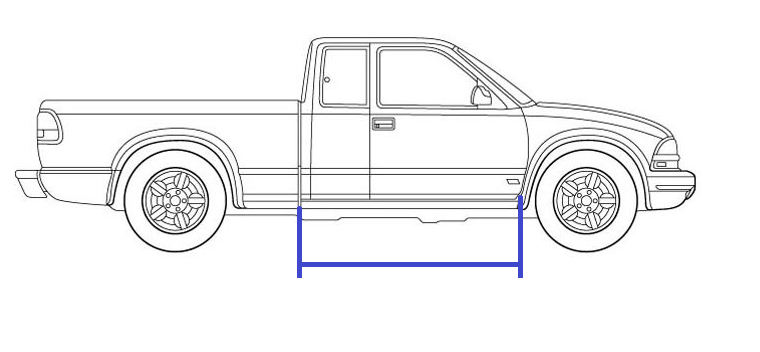

I have decided to lose some weight on my rig, like everything but my drive train. I just want something lighter and slimmer. So I'm going to start collecting parts for an S10 build. I plan on a 4 link front and rear, and a tube chassis. I want to do an extended cab, but not if my wheelbase will be more than 117". I need to get dog house measurements on standard and extended cabs. Anyone on here have one they can measure?

That would be great. Thx. The most important measurement is from the cab rear to the cab front. I can measure out the wheelbase from that.
Old 02-08-2016, 07:39 PM   #165
Cab front? The leading edge of the bottom of the door?
Like this?
Like this?
Cab front or where ever the tire would rub minus the fender.

Stock wheelbase for extended cab S-10 (1st and 2nd gen) is 122.9".
The factory K5 wheelbase is 106.5" in regards to the picture above with an extended cab S-10 on a K5 frame, and assuming he kept the axles in the same location.
Assuming you want to keep it pretty low the front axle will need to be stretched forward quite a bit to clear the firewall with 39.5" tires, plus it will help with approach angles. I think you will be able to stay right around 117" but probably won't have a lot of play room without getting into the cab with either the front or rear tires.

His extended cab is 68.5" from the back of the cab to the lip of the front fender, measured along the rocker.
That's 20.5 for the extended cab, 44 for the door, and 4 for the fender.
There's probably a couple inches to be gained between that lip and the front corner of the actual cab, but I couldn't verify without pulling out the fender liner.
Old 02-10-2016, 08:27 PM   #175
Lets do some math. I currently have 21" between the rear of the cab and the rear tire. If I move the front forward 4.5", the rear goes the same to keep my 117". Now I have 16.5" between. subtract another 12" for the ext cab and now I have 4" between. I could probably cheat 1-2" from the front since the cab isn't as wide and the cab mounts should be different. It will clear, but won't it look weird with the cab that close in the rear. I know, I can cut the cab down so it's the same size as my cab. I don't know if I'll like the cab being 3" smaller. There's barely enough leg room now. I'd have to sit at a 90 degree angle... I need to sit in a reg cab and see.
