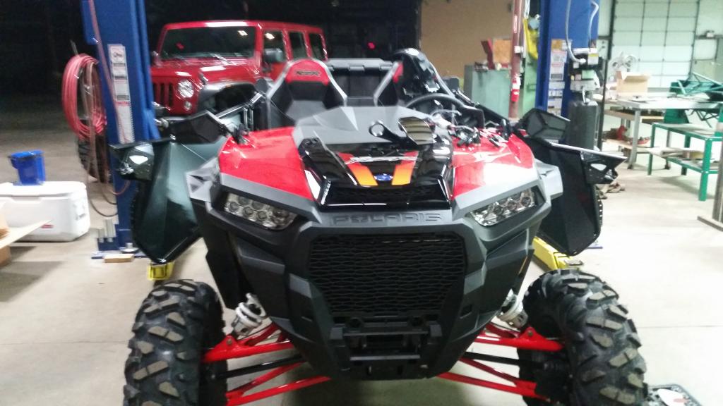

Old 01-06-2017, 10:48 AM   #4

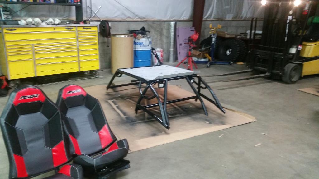

Putting on doors, building cage and adding 4 point belts.
ID:	9216   Click image for larger version

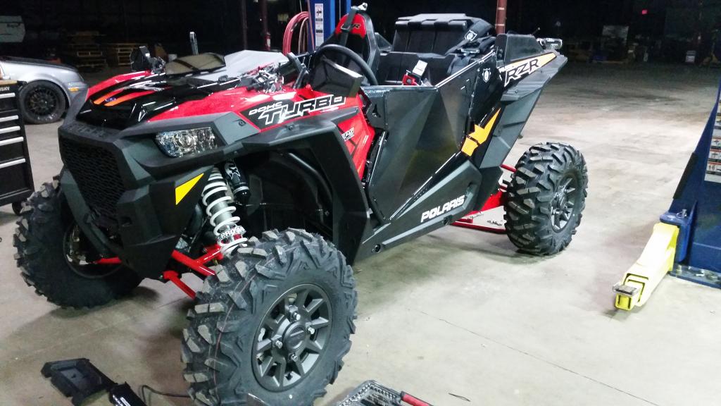

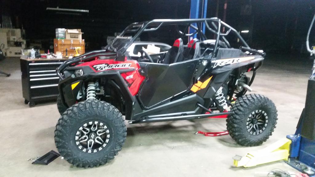

Cage partially fabbed, 32" tires with beadlocks installed.

Don't forget an UHMW skid. Even with those I have managed to bend up my cross members on both the 2 and 4 seater. I think Polaris needs to add some more beef to the cross members and lower frame rails.

Location: Circleville Ohio
is it me or is the side step awfully close to that rear tire?
1976 CJ 5
1984 CJ 7
1993 K3500 GMC 6.5 TD
Old 01-10-2017, 04:20 PM   #10
[QUOTE=tbshakie;87552]is it me or is the side step awfully close to that rear tire?[/QUOTE
Must be you. Check the camera angle. Has plenty of clearance.

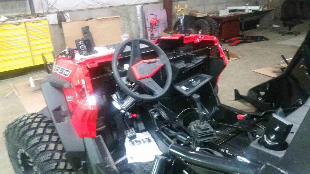

Removed dash and console for wiring. Cage finished up. Winch, light wiring left.
ID:	9225   Click image for larger version

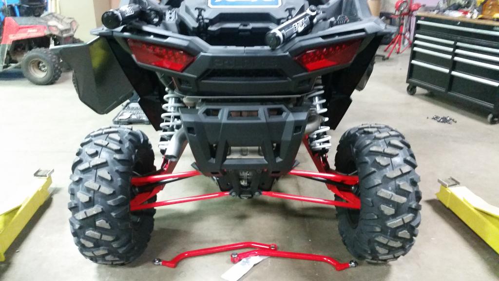

Installing high clearance radius arms. Rear bumper will need to be clearance for this to work with full suspension travel.

Cage is .120 wall in critical areas and .090 in remaining areas. Gussets double as grab handles and anchor points. Tied into bumpers as well as the front and rear frame. This will improve the factory cage structure and integrity by more than double.
One big dilemma is weather or not to build the front diff before it blows. It will be easier to get to with the winch out. This entails a stronger billet bearing cage from 7075 grade aluminum, roll pin upgraded from .093 to .125 hardened dowel, hardened toner ring and spring tuned. Not sure yet.
Old 01-18-2017, 06:33 PM   #20
Build the diff now. With that much power and bigger tires, it will die. Plus, I've seen the way you drive.
