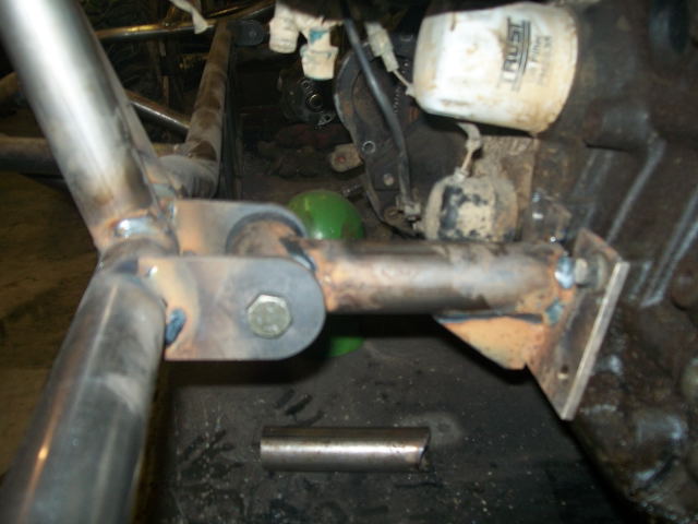

motor mounts..

Yes, some nice lines... and some wackiness that I like too... that tcase mount is interesting...
Extra roof and floor bars to keep the doors open, or just making fabrication easier for now?

i love the lines of you chasis, the double b pillar, and the extra gusset running parralel with the rear down tubes (c pillar, whatever the hell its called). 1 question though, do you have a mid mount on the tranny or front tcase? seems like a long ways back to have your tcase mount from your motor mounts, with the torque of the dual cases, i'd be afraid of something wanting to twist in the middle? of course, i've never messed with toyota stuff, and maybe this si the normal way to mount them. looks sweet none the less, and i really like your rear mount. also, them are some nice looking tires.
greg
Old 01-29-2010, 07:59 AM   #48
greg
i thought the same thing on the t case mount greg but i was doin some research over the summer looking for flat belly mounts in my truggy..found that front range makes and sells a crossmember kit just like this one...i made a program and machined one out just to try it on my truggy..ran it all summer and i think we have like 2 or 3 trucks runnin around now with the same setup...it works really well and actually on a truggy with stock motor mounts it stiffens everything up and keeps it from junkin motor mounts...and yes tires are sexy lol...wanna groove my new ones for me??
its gonna have door bars just makin it extra strong cause i dont wanna work on it lol i tend to beat **** pretty hard..
