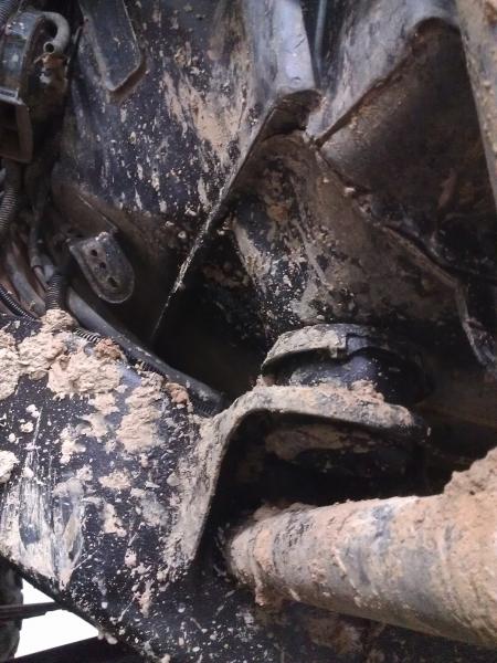

If I get creative, I could make 42's fit without moving the axle forward. I could notch the firewall some more and do something with the cab mount. This sounds like a plan.
