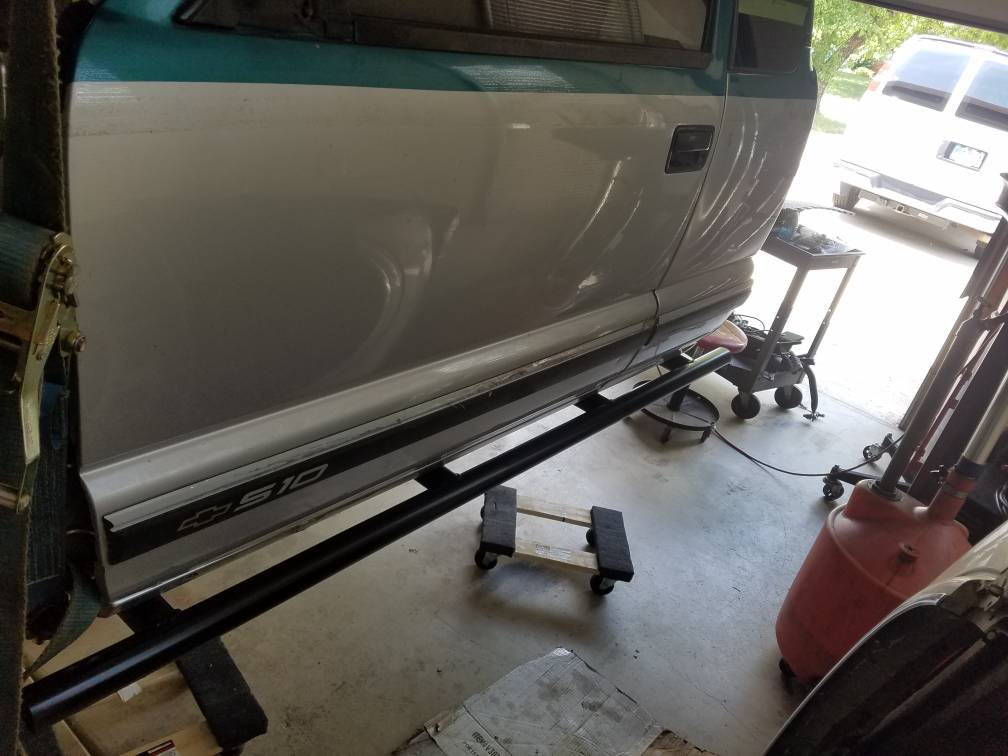

Just about done with the main frame and rock siders. I used some of the 2 1/8 x .188 DOM from the old rig for the sliders. I pushed the support tubes through the box where the exo will come down. It was a lot of work, but should be really strong.

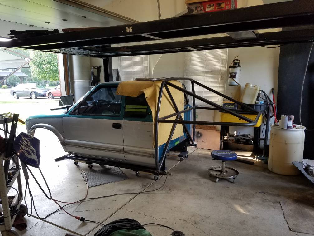

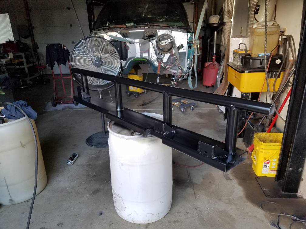

Old 08-07-2018, 04:38 PM   #52
Got the other side done. Ready to bend some tube. Click image for larger version

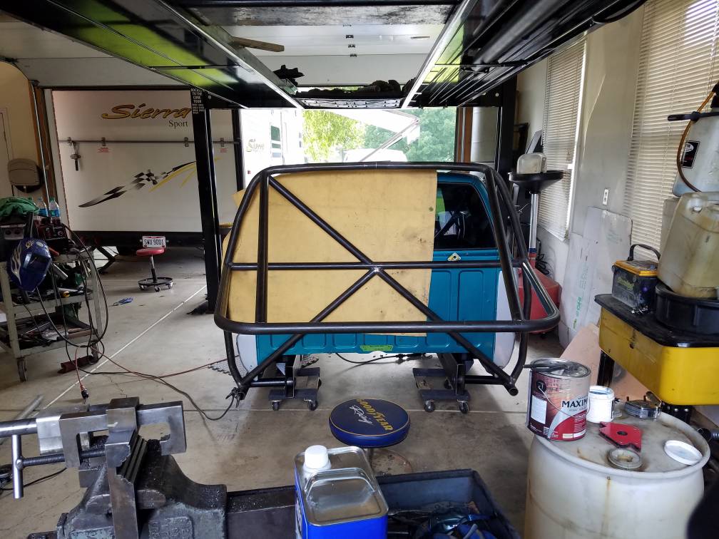

Old 08-12-2018, 09:28 PM   #53
Got the rear hoop done. This is the hardest one to bend in my opinion. I like to keep gaps tight so it has 13 bends in it. The tube is behind the cab so the pic from the back is deceiving. Going to work on the back next.

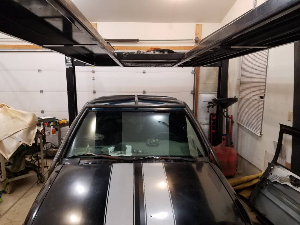

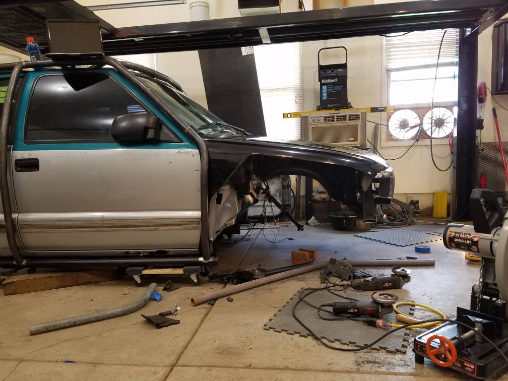

Old 08-26-2018, 09:03 PM   #59

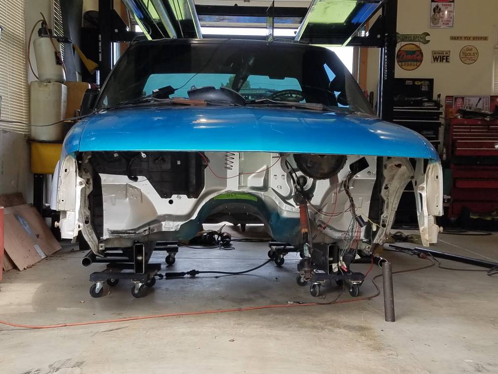

Made some progress on the build this weekend. Still debating on how to do the front.Click image for larger version
ID:	9986Click image for larger version
ID:	9987Click image for larger version

Old 08-27-2018, 11:54 AM   #62
Awesome Kevin!
Are you expecting to remove/rework any of the cab floor to keep a relatively flat belly?
The main reason I ditched the S10 frame was to duplicate the full size frame so I could keep the belly flat. The area under the S10 is really close to the full size so I shouldn't have to do anything to the floor pan. How it actually works out is another thing.
Old 08-27-2018, 12:36 PM   #63
I always liked the old rig better when it had the fenders on it, so I'm thinking about leaving them on this time. The S10 is a little wider in the front than the big rig was. I think visibility out the front is a lot better in the S10, so do I dove the front or leave it straight. I originally wanted to do all tube in the front, but I don't think it would look right. The fenders will need to be cut along the silver/teal line so there won't be much fender left. The factory grill will be cut to remove the headlights. Since the radiator will be behind the cab, the approach angle should be good.

I am leaving the fenders on, but may cut and dove them some. Dovetailing will help with bending the tube around the front of the grill. I measured the length of my old rig and the new one is about 26" less. So that's -13" wide, -4" high, and -26" long. Hopefully it's 800-1000 lbs less. I won't know how to act.

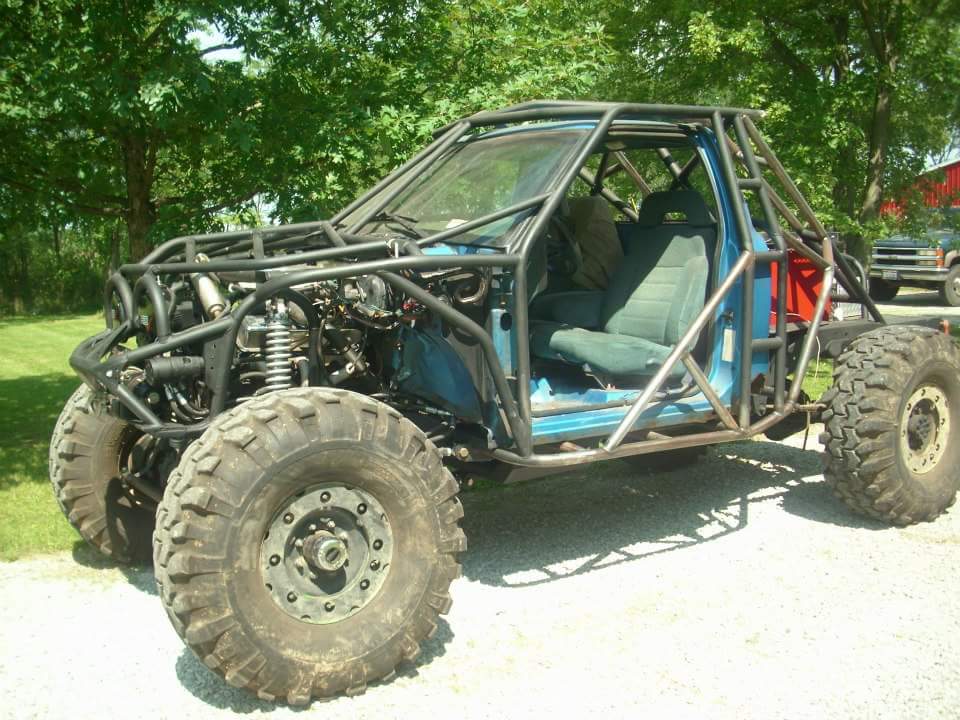

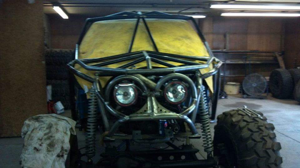

Kevin here's a pic of a buddy's s10 with exo, thought maybe you could use to envision yours.
Are you wanting a 205? I think I know where is.

I do like the front of that rig. Do you have anymore pics of it?
I am thinking about doing a 241/205. I might be able to buy back a 205 I sold someone locally. I was checking out the eco box from NW fab. I already have a 241 to source parts from.
Attachment 10029
Having my buddy send me some more pics of his rig.
I love having the doubler. Although I did lose low in it last wknd. Not sure why right now, will let you know when I tear into today.
Let me know on 205. I know we've got one laying in shop.

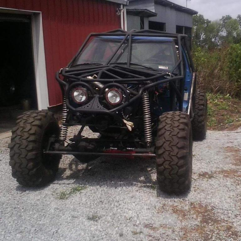

Pics
Here ya go Kevin.
ID:	10030   Click image for larger version
ID:	10031   Click image for larger version
